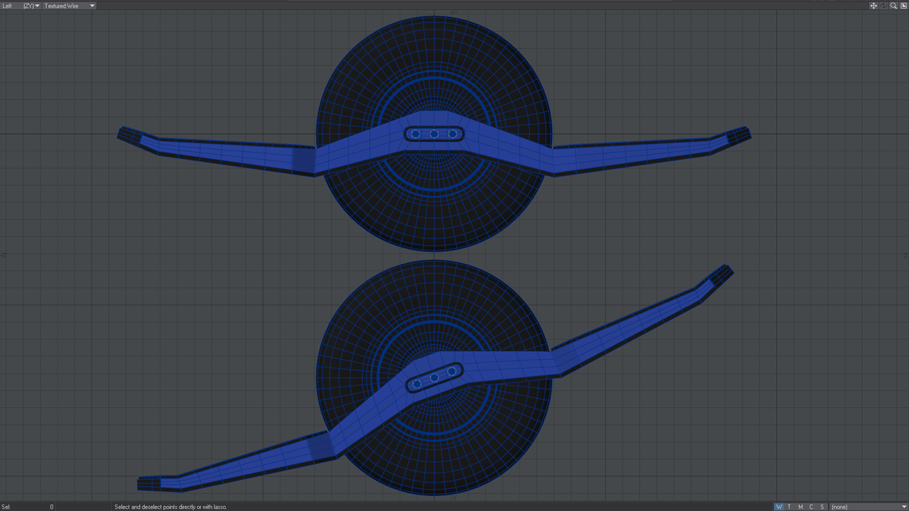

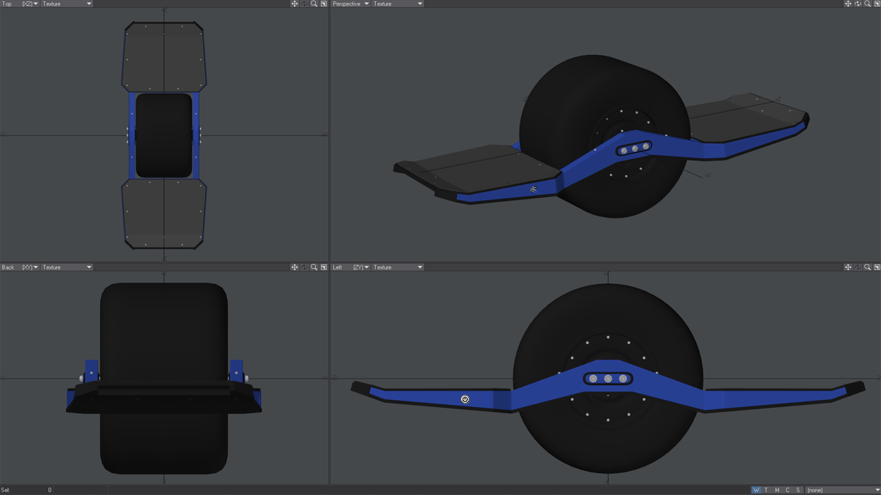

    bryphi77 @carvewell 13 February 2016, 23:12 UTC
    @ashewheeler I totally get that the product needs to be manufactured at a reasonable price, but the current design is not perfect at all. From a rideabilty standpoint there is a ton of low hanging fruit that can be picked. IMO for $1500 a much better board can be produced and profited from. I am not taking anything at all away from this product... I just hope that this guy does not stop trying to improve it because there are many things that can be better.
    Its fine if he doesn't want to improve on it, but I hope he doesn't try to stop others from making a better product.
    For $1500 this is what you should be getting IMO.
    C 1 Reply   Reply Quote 1
    bryphi77 14 February 2016, 00:01 UTC
    I just want to add... I am only posting these here in hopes that they will be ripped off and produced... Feel free to use any of these designs in future Onewheel.
    I do hope that the design is changed, because anyone who thinks that the current design is optimal from a quality of ride standpoint doesn't really know what they are talking about. The ride can be improved greatly with current technology just by changing the design.
    C
    carvewell @bryphi77 14 February 2016, 00:08 UTC
    @bryphi77 your modeling is asthetically brilliant! I love the re-imagined monolithic frame and lowered deck concept, however never having ridden OW I think you are operating from a limited perspective. The lowering of the deck would represent a huge loss in clearance unless a larger diameter wheel was used which could be very advantageous in approaching obstacles or bumps similar to the advantage of a 29" mtb wheel over a 26"(keep in mind this advantage is not achieved without compromising cornering). The current design already is running a little short on clearance so would hate to loose any. The solid monolithic frame you have rendered is super rad! However if you had examined the current version you would see how much weight in aluminum your design would add. I'm guessing 5 lbs or more. The current frame rails while being cnc machined from solid aluminum are not solid at all they are largely hollow or channeled to shave weight. The current onewheel is carefully balanced and is hefty but as lightweight as possible without using more expensive materials like titanium or carbon. The current rectangular shape is what I like to call a "landguard" shape. Like the vanguard shapes you see in the surfing world that have been truncated of their tips to eliminate excess the OW only touching the riding surface at the wheel has truncated all but the essential rectangular footprint of the rider. People may want to see a more familiarly shaped board underfoot but it is not needed. Again this minimalism IMO is a value to the customer and the manufacturer. I really doubt that your monolithic frame concept could be manufactured more cheaply than V1. I'm not saying V1 can't be improved or that some of your recommendations shouldn't be explored I just absolutely hands down disagree that the current design is not brilliantly conceived, shaped, and manufactured. After riding 6 months now I even more appreciate the manufacturing and design decisions FM landed on. The more I ride it the more capable it becomes and it continues to exceed my expectations every time I step on the board. In the end I can appreciate your ideas but not your criticism of the OW because you haven't ridden one. If you had experienced the OW underfoot you would not have anything but praise for its uncanny genius!
      Reply Quote 4

    bryphi77 @carvewell 14 February 2016, 00:28 UTC
    @ashewheeler
    I had considered clearance. If you look at the original it is much thicker at the ends and does not have any bend to it. I tried to make the rotational freedom the same as the original design. It may be one or two degrees less here, but even that could fixed by shortening the over all length of the board by a little bit.
    I know I haven't ridden one of these, but I do have a good grasp on physics. I tend to think this design was made from a durability and production cost stand point, not from a quality of ride stand point.
    I wonder how many designs were tested for ride quality before this was settled on???
    And I have said over and over that this is an awesome product, I just hope that the design is moved forward because I feel that is where the ride can be improved most easily.
      Reply Quote -1

    germx @bryphi77 14 February 2016, 00:38 UTC
    @bryphi77 While that looks great, I guess there's a problem with slimmer and angled pads. I'm mostly thinking about the battery and how much less space there is for it. But I do see the positive sides of it.
    Apart from that, I'd love to test that out.

    bryphi77 14 February 2016, 04:35 UTC
    This is probably even better. It takes care of the clearance issue. It gives a bit more angular freedom than the current design. It also may be the most natural foot position.... being that the legs are spread so far.
    Franky 14 February 2016, 04:52 UTC
    What if you invert that up instead of down?
    I'm not sure if I'm understanding your theory of why riding closer to the ground is better.

    bryphi77 @Franky 14 February 2016, 05:16 UTC
    @Franky Its not only being closer to the ground that is better, but even more so having your feet bellow the axle that will make a huge difference. With your feet below the axle it takes much of the stress off of the motor trying to keep you upright, and instead your own weight is now doing some of the work. This is one of the biggest things that can help stability.
    Honestly, this will be my last post on the issue. Future motion can feel free to rip parts of the design if they want. I really hope they do...
    Franky 14 February 2016, 06:37 UTC
    Again I suggest you ride. I would not say stability is an issue for most including beginners. When you ride, you will discover that it's very stable but also what pushback feels like. Pushback is an artificial safety mechanism meant force rider to slow down instead of crashing after riding so fast that the board cannot keep up with the weight leaning forward.
    I personally don't understand why a design going down would be more stable than a design going up or the current design being middle of tire. It seems to me like if everything is balanced evenly then it won't matter where you are balancing. Please explain.
    B 1 Reply   Reply Quote 0
    bryphi77 14 February 2016, 06:46 UTC
    I guess the best thing that could be done from a business stand point is to continue selling the current version, but also develop a better model that would go for maybe $2500. That way he would have a better product to sell to the people who already own the current version.
    bryphi77 @Franky 14 February 2016, 06:51 UTC
    @Franky
    I see the stability issue I am talking about in every vid I have watched. Its not that it cant be ridden, its that there is a better design that will ride better. Unless we are back to the same idea that the model t was the pinnacle of car design and no other designs should be tested
    I could just as easily say the same thing to you... You are basing all of your opinion without ever testing another design! So... I may not have ridden this one, but you certainly haven't ridden what I have shown either.
    thegreck 1 Reply   Reply Quote -1
    thegreck @bryphi77 14 February 2016, 07:02 UTC
    But you haven't ridden either of them.
    B 1 Reply   Reply Quote 1
    bryphi77 @thegreck 14 February 2016, 07:05 UTC
    @thegreck Dont have to ride either to understand the physics of it. Most of the stuff I have mentioned are based on basic physics concepts.
    A 1 Reply   Reply Quote -1
    aris @bryphi77 15 February 2016, 12:18 UTC
    @bryphi77 Your enthusiasm is great man, but really, if you understand design, you understand the need for real world experience. Theory is never sufficient. Trial and error. Trial and error. Try it before you so forcefully defend your suggestions.
    B 1 Reply   Reply Quote 2
    bryphi77 @aris 15 February 2016, 12:53 UTC
    @aris I guess the same thing could be said to Mr Doerksen. Its already been established in this thread that the current design was the only one tested.
    I forcefully defend my suggestions because I know for a fact they will produce a better ride. Like I said... the laws of nature cant be twisted.
    1 Reply   Reply Quote -2
    No 15 February 2016, 14:20 UTC
    @aris, well said. Good ideas are the easiest part. It is literally the FIRST step of development, but @bryphi77 hasn't gotten any further than the "idea stage", yet he speaks with the arrogance of someone who's already had success.
    @bryphi77 , in this thread, every time someone opposes you, you take it as an attack on your ideas and accuse them of being afraid of change or being stuck in their ways. I don't think you realise that nobody here opposes your ideas, they oppose your personality, and the manner with which you express your ideas.
  • germx
    germx 15 February 2016, 14:45 UTC
    Now now, calm down people. It's far from easy to test designs for this kind of vehicle. Especially for people not affiliated with FM, who just want to improve the design.
    A little less defensiveness from both sides, and a bit more open discussion about pros and cons in design please.
    As it stands, discussing it is all we can do, unless someone wants to disassemble their board and remake the frame. Didn't think so.
  • germx
    germx 15 February 2016, 15:26 UTC
    So if we analyze the design, and we suppose it works as intended. What are the pros and cons?
    They way I'd see it:
    Pros.
    Better stability.
    Improved control (weren't the pads supposed to be concave? Can't see it).
    Slightly reduced weight.
    Design (obviously subjective).
    Cons.
    Reduced clearance close to the wheel (shouldn't be an issue, something that high would be nigh impossible to traverse anyway).
    Reduced space for battery compartment (and electronics, no idea if it's an issue or not).
    Part hitting ground isn't covered in plastic?
    More complex manufacturing process.
    Unknown
    Carrying options (handle).
    Durability.
    Did I miss something?
  • chabis
