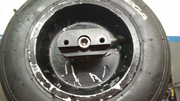

    My rim looks camouflaged from all the tire changes.
    Shot a video of him changing it, I'll post it when it's uploaded.

    @sonny123 Yikes. 10 minutes to change the tire when there are two people doing it with proper tools. I might have to send mine in. Wish I had two boards!!
      Reply Quote 0 2 Replies
  • sonny123 @thegreck 10 April 2017, 18:52 UTC
    Yes, I think it's good to know it can be a bit of a hassle,
    between finding a shop that'll agree to do it and the scratches you end up with.
    Some guys are able to swap tires by themselves but it ain't easy.

    @CBR-954rr
    True, last time he had easier time and did it alone.
    I think the toughest part is breaking the bead.
    Removing the tire from the rim can be done at home with the right tools
    and you can place some materials on the rim to protect it from scratching.

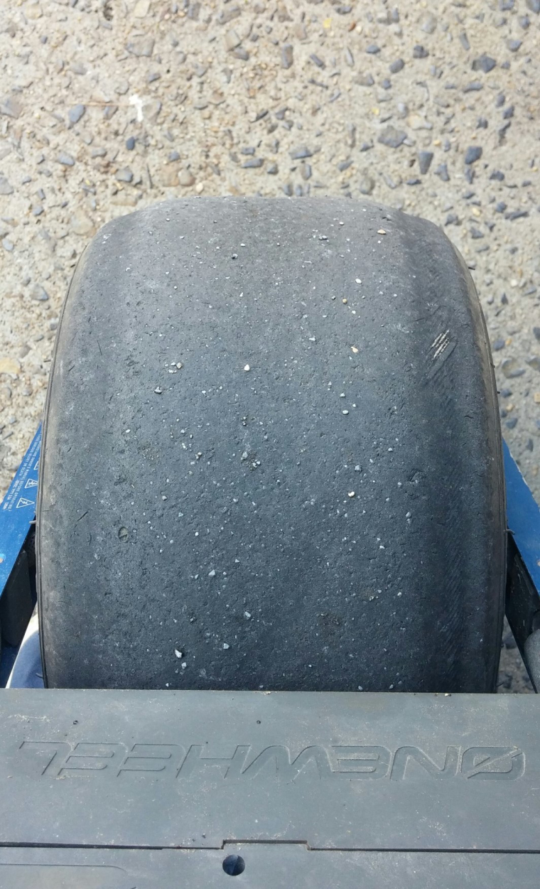

    I looked at an old tire I had and they do wear on one side more than the other.
    So rotating it might buy you some time.
    I'll see how long mine does after today's rotation.

    Yikes, that was brutal to watch. No regard to scratching or gouging the rim. It looked like the way you change a bike tire when you are a kid with brute force and screwdrivers. I would not take my business there again.
  • sonny123 @RandomNate 11 April 2017, 14:24 UTC
    @RandomNate
    Well, if you care about not scratching the rim, send it to FM.
    I don't care, and for $15 tire swap, I can't expect much.
    I like the rugged look.

    the use of proper tools is questionable...those looked like screwdrivers
  • thegreck @CBR 954rr 11 April 2017, 15:05 UTC
    @CBR-954rr I had to assume they would have proper tools, but since I don't know what they look like, I figured they must just look a lot like screwdrivers and also be insanely difficult to use.
  • sonny123 @CBR 954rr 11 April 2017, 15:18 UTC
    @CBR-954rr
    Well, he's not equipped for Go Kart tire change.
    But he did use some special spoons.
    One way of doing it to avoid scratching is to cut out the old tire.
    You'll need pretty heavy duty cutter for the bead.
    Then there's a trick to getting the new tire in with minimal damage to the rim.
    I recall on their Headquarter tour video, there's a shot of the guy putting on the tire.
  • sonny123 11 April 2017, 15:21 UTC
    That's not a bad idea...I may resort to that if my tire change doesn't go smoothly. I'm sure an angle grinder or dremel work make short work of it.

    I find that the lower the pressure the more the wheel will wear from the edges, so I vary the pressure also to wear the tire evenly.

    Rotating the tire can almost double its life.
    Did mine a month ago and been riding daily multiple times.
    The wear that used to be on the left side is unchanged.
