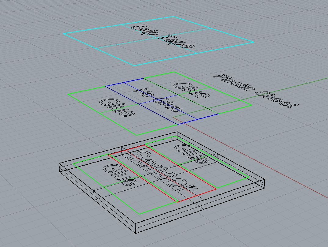

    @jeremyschow
    Notes: The entire grip pad is glued to a thin plastic sheet, the area on the sheet that covers the sensor MUST remain glue free. Cover/protect it when respraying/regluing.
    The areas to the Front and Rear of the sensor have thin plastic sheet sections that are glued directly to the wooden pad. Your grip pad/full plastic sheet assembly will be glued to these to complete the job.
    The end result is the upper and lower third of your front pad gets glued, the center third(sensor area) is glue free and free floating.Pad map.JPG
    J-Glide 1 Reply   Reply Quote 5

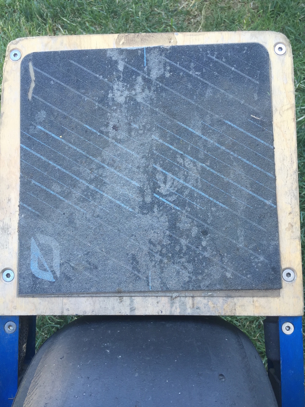

    Can I keep riding until it gets worse? Im worried about damaging the sensor underneath.
    J-Glide 1 Reply   Reply Quote 0
    J-Glide @pteasima 10 July 2015, 18:56 UTC
    @pteasima I wouldn't worry about it damaging the sensor. If it gets a little glue on it, you can use a product called goo gone to get it off
    Franky 11 July 2015, 00:40 UTC
    @pteasima, mine looks exactly the same but still works fine.

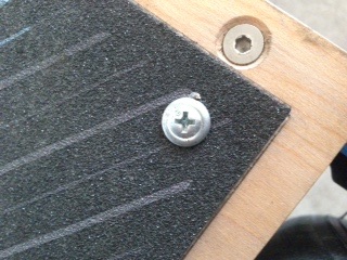

    @lynnpreston I tried the screws through the grip tape. It worked like magic! I used some very short pan head screws. Three across the front, and three across the back. Even after several hot days my grip tape hasn't moved. This was a brilliant idea!!!
    D 1 Reply   Reply Quote 2
    DVO @J-Glide 16 July 2015, 02:56 UTC
    @J-Glide If you have time, can you post a pic? And the size of the pan head screws please.
    J-Glide 2 Replies   Reply Quote 1

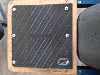

    D 1 Reply   Reply Quote 3

    DVO @J-Glide 16 July 2015, 19:12 UTC
    @J-Glide thank you very much brother! What size screws? So I don't go too deep
    J-Glide @DVO 16 July 2015, 19:40 UTC
    @DVO I want to say they are quarter inch size screws, but I also removed the footpad to make sure that if they did go through they didn't hit anything. The ones you need to worry about the most are the ones closest to the lights.
    D 1 Reply   Reply Quote 1

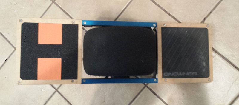

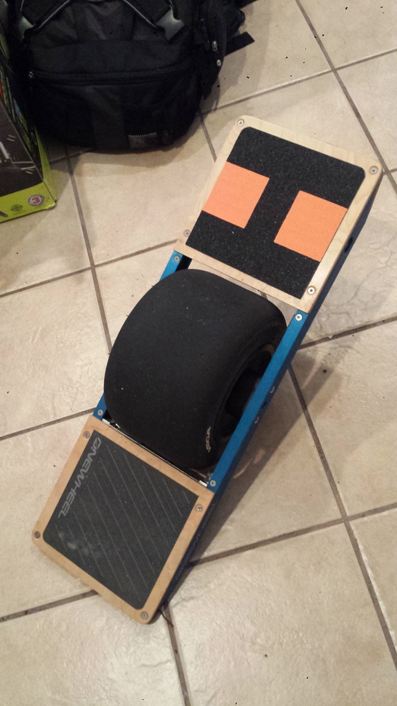

    when you re gripped, why didn't you make the grip bigger and cover the whole panel and then use the 4 corner holes to help hold the tape in place?
    Order Date 08/17/2015 - 00:33 GMT 16:33 waiting for my Onewheel!
    veryous B 2 Replies   Reply Quote 0

    Boogieman @eish 20 August 2015, 02:51 UTC
    @eish - I could have went for full coverage, but I like the look of wood showing around the edges. I've regripped again and eliminated the plastic sheet insert. I'm using a folded sheet of card stock over the sensor. Grip tape now has more wood to grab onto and has not moved at all even in 90+ degree northeast riding weather.
    eish veryous 2 Replies   Reply Quote 1
