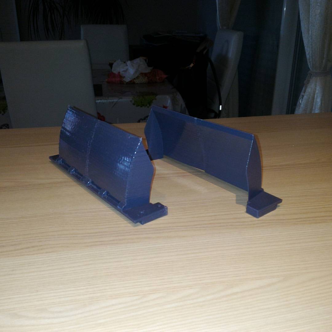

    Tartopom @Dude 2 July 2016, 22:58 UTC
    @Dude no problem, I'm currently printing the second half of the first side of the fender, then I plan to weld them together using acetone, as I'm printing or using ABS :-)

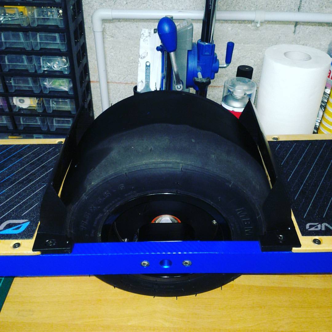

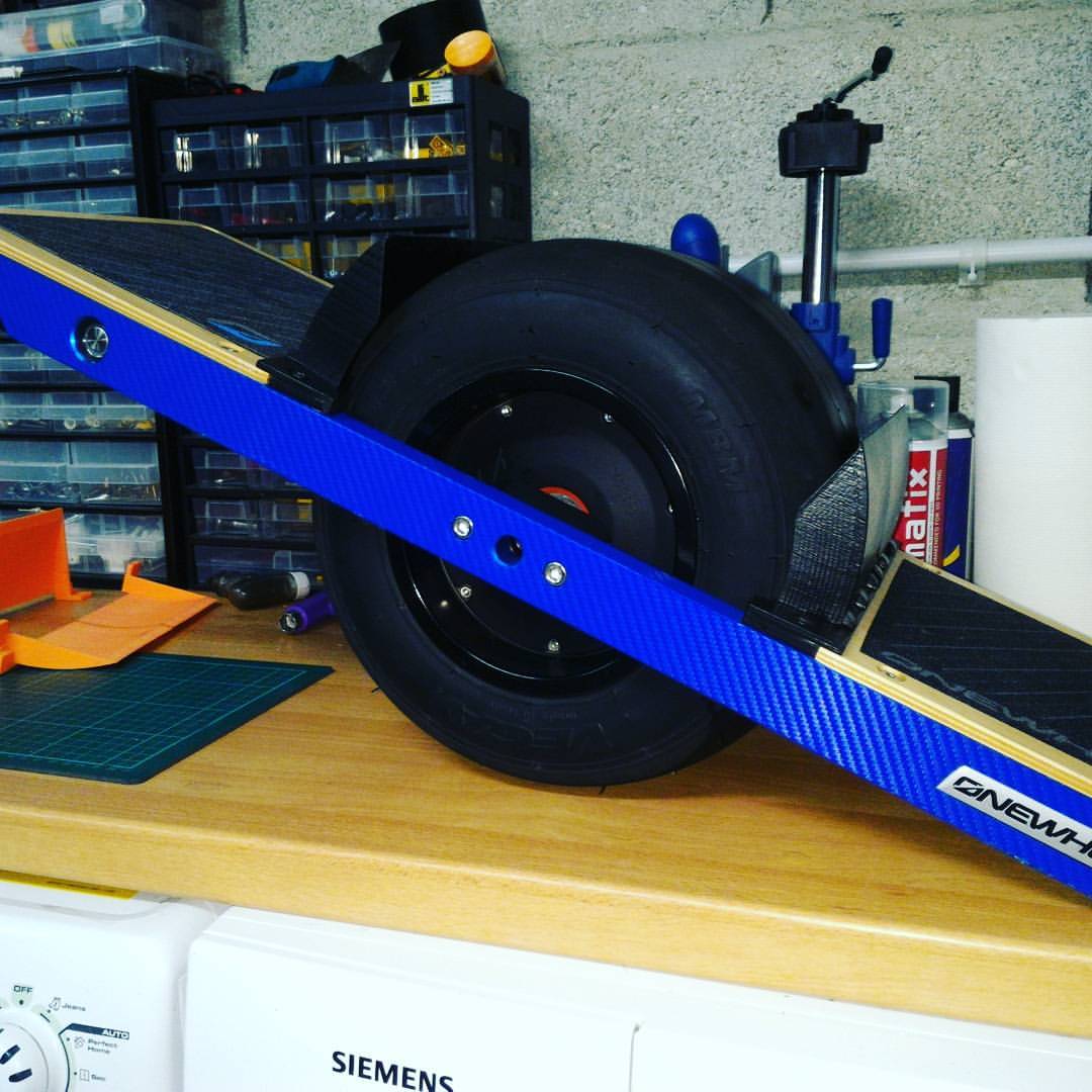

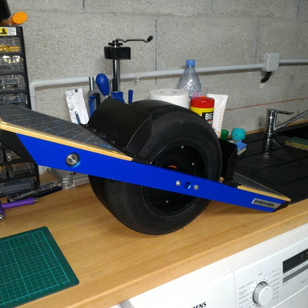

    Tartopom 14 July 2016, 22:39 UTC
    And the new mini fender v3 is printed and installed :-P
    ![0_1468535930105_IMG_20160714_202423.jpg](Uploading 100%)
    ![0_1468535960903_IMG_20160714_202519.jpg](Uploading 100%) ![0_1468535979223_IMG_20160714_202242.jpg](Uploading 100%)

    mike @Tartopom 17 July 2016, 21:22 UTC
    @Tartopom sounds really great what you've done!, those installed pics don't seem to work, any chance you could repost them? thanks

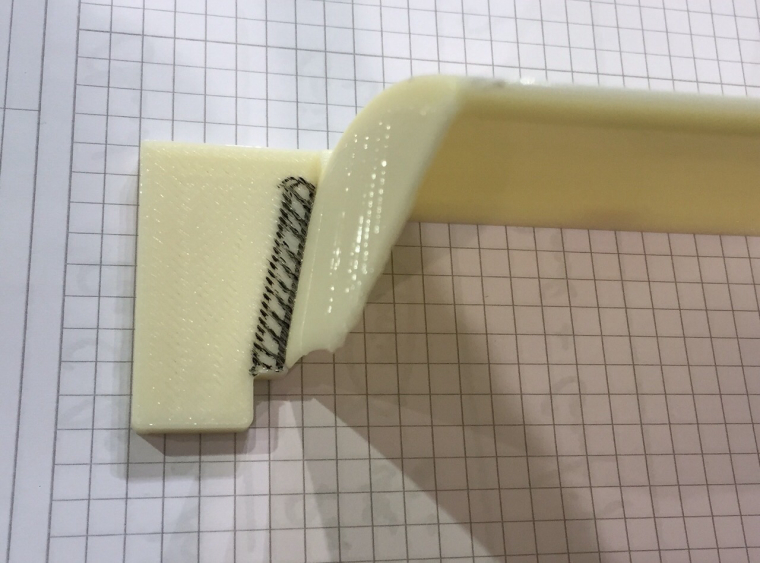

    Salut Tartopom!

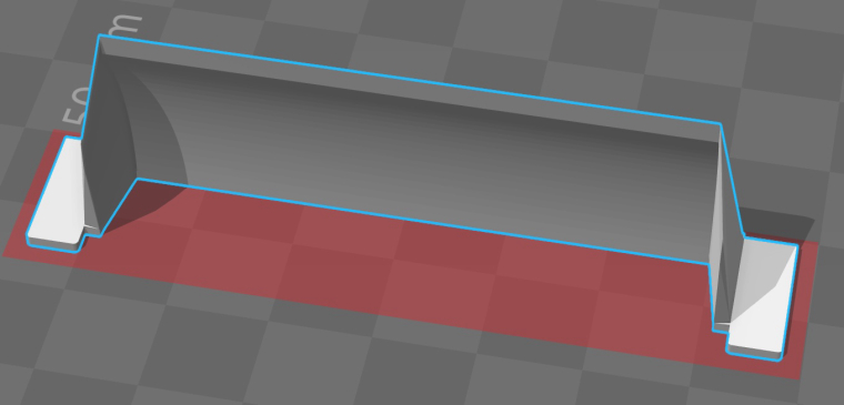

    J'ai eu accès a une Stratasys et ai lancé la V3, j'ai un problème de parois trop fines.
    I switch to English :
    If you print "too thin' there is a Pb on the V3 which I cannot solve with the STL's.
    The stratasys cannot print thicker the sides are not behaving nice while printing.
    Since the sides are not plane so I cannot 3D extrude them!
    Maybe the original 3D file allows to thicken the sides ?
    On the pictures below, I've marked in black how thick it could be improved from the base.
    Could you help me there?
    Thanks
    Arnaud
    PS: Will post photo later, need to resize them, not fancy on iPad...
  • Rno
    Rno 9 December 2016, 19:02 UTC
    Here is the Pb when too thin :
    Why not thicken this part :
    Too hard from the STL file as not plane... probably a problem between my seat and the mouse as well ;-)
    What would you recommend ?
    Bye
    Arnaud

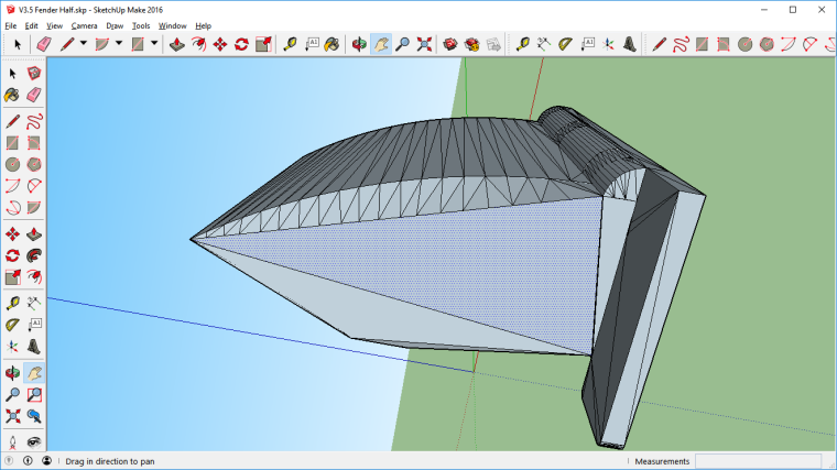

  • Rno
    Rno 9 December 2016, 21:29 UTC
    Finally
    I've launched tutorials on 3D drawing and made lot's of triangles to reinforce the sides:
    Looks like nothing but probably stronger...

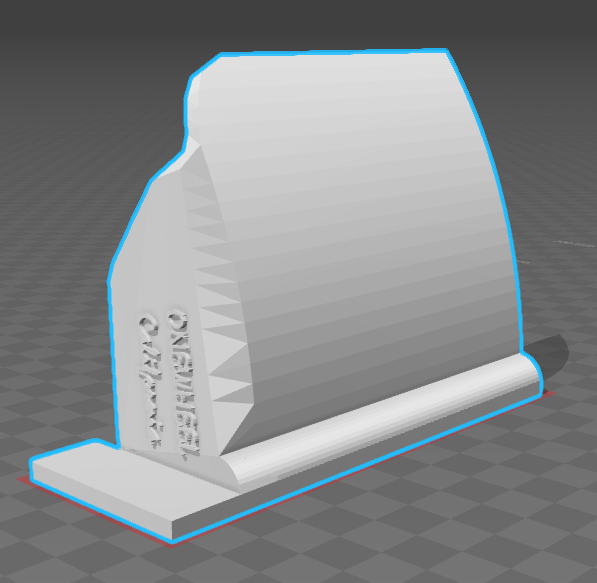

    faskev 14 December 2016, 23:41 UTC
    Cool work put into this! I tried using thingiverses in house 3D printing service but it errors out and when I upload the files to sculpteo it gives me an error "Design has fine details which will break, please review its solidity" and won't let me proceed. I don't know anyone with a printer and can't afford one myself but does anyone know how I can get these beauties printed online?
  • Rno
    Rno 15 December 2016, 09:11 UTC
    Hello, this is a minor fix @faskev
    I have removed
    • letter details that could jam the process.
    • the male / female insert supporting assembly that could block as well
    Fix is at the same place: http://www.thingiverse.com/thing:1956405 new files.
    Try downloading the "SIMPLIFIED V4.0 Fender Half Rounded.stl" and Mirror it should fix your Pbs.
