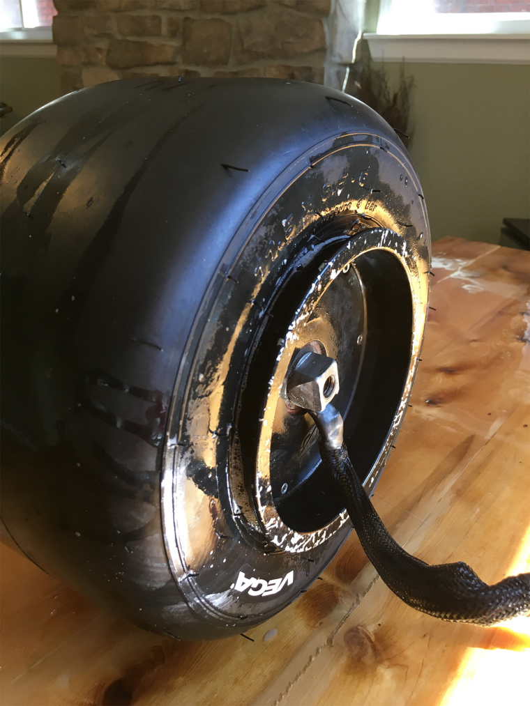

    blankets 8 March 2017, 16:07 UTC
    @njcustom I got the tire spoons and they worked! It was much easier to get the bead onto the rim.
    New problem though: the tire doesn't seem to want to inflate all the way. I went to a gas station and used their free air to inflate to 20 psi. The bead just won't inflate to the edge of the rim. Should I buy slime and try to inflate again? The wet part of the tire is windex; I thought that would help the tire inflate smoothly...
    sonny123 njcustom 2 Replies   Reply Quote 1
    sonny123 @blankets 8 March 2017, 16:15 UTC
    @blankets
    You need lots of pressure.
    Guy at the tire shop had a hard time too.
    Then he used another hose with stronger pressure and boy, when that thing popped,
    I was like YAY...
    njcustom @blankets 8 March 2017, 16:15 UTC
    @blankets spray the bead with Wd40 to help it slide on, not windex...Then use alot of air.. I once had to use 60+ psi to get it on.. it might balloon a little but that's OK.. also you will need to remove the valves internals. The air goes in much faster with it out.. you will need the special tool for that.. couple bucks at Walmart or auto part store
    B 1 Reply   Reply Quote 3
    blankets @njcustom 5 June 2017, 02:36 UTC
    @njcustom It's been a few months but I just got around to trying 60+ PSI and you were right, that set the bead nicely! The hard part was actually finding a shop that was willing to inflate the tire to 60 PSI, since most shops actually turned me away. Mr. Tire ended up doing it for free for me. Thanks again.

    So, after reading this and many of the replies I tried this myself.
    I haven't ever changed the tire on a Go Kart before but figured it couldn't be all that hard.
    It wasn't easy but I did get the tire off and, for the most part, the new one back on.
    (and yeah you can tell from the pictures it wasn't pretty but it's holding air perfectly fine.)
    Where I'm stuck is getting the bead to seat 100% on one side.
    It's totally sealed on 'side a' but 'side b' has a small portion that won't seat.
    I tried taking it to a local tire shop (not a Go Kart place but a professional tire shop) they couldn't get it seated either.
    The tire is totally holding air too. I'm 1/2 tempted to put it back on and ride it (my thinking is the weight will eventually pressure the tire into place.
    Any other thoughts? I tried WD-40. Is there something better to use?
    I did see some YouTube videos where guys were using silicon spray... is that a thing?
    Just looking for ideas from the experienced.
    Cheers,
    Kaz
    sonny123 G njcustom B 4 Replies   Reply Quote 0
    sonny123 @Kazdoom 10 November 2017, 13:20 UTC
    @kazdoom
    Try unbeading it again, move it around, heat up the tire and make another attempt.
    Gwinntanamo @Kazdoom 10 November 2017, 21:47 UTC
    @kazdoom You may need to pump it up to a much higher pressure than you intend to ride it to get it seated. Also, use a heat gun or something to soften the rubber if necessary.
    poppavein 10 November 2017, 23:32 UTC
    Use soapy water for a lube when changing tires.
