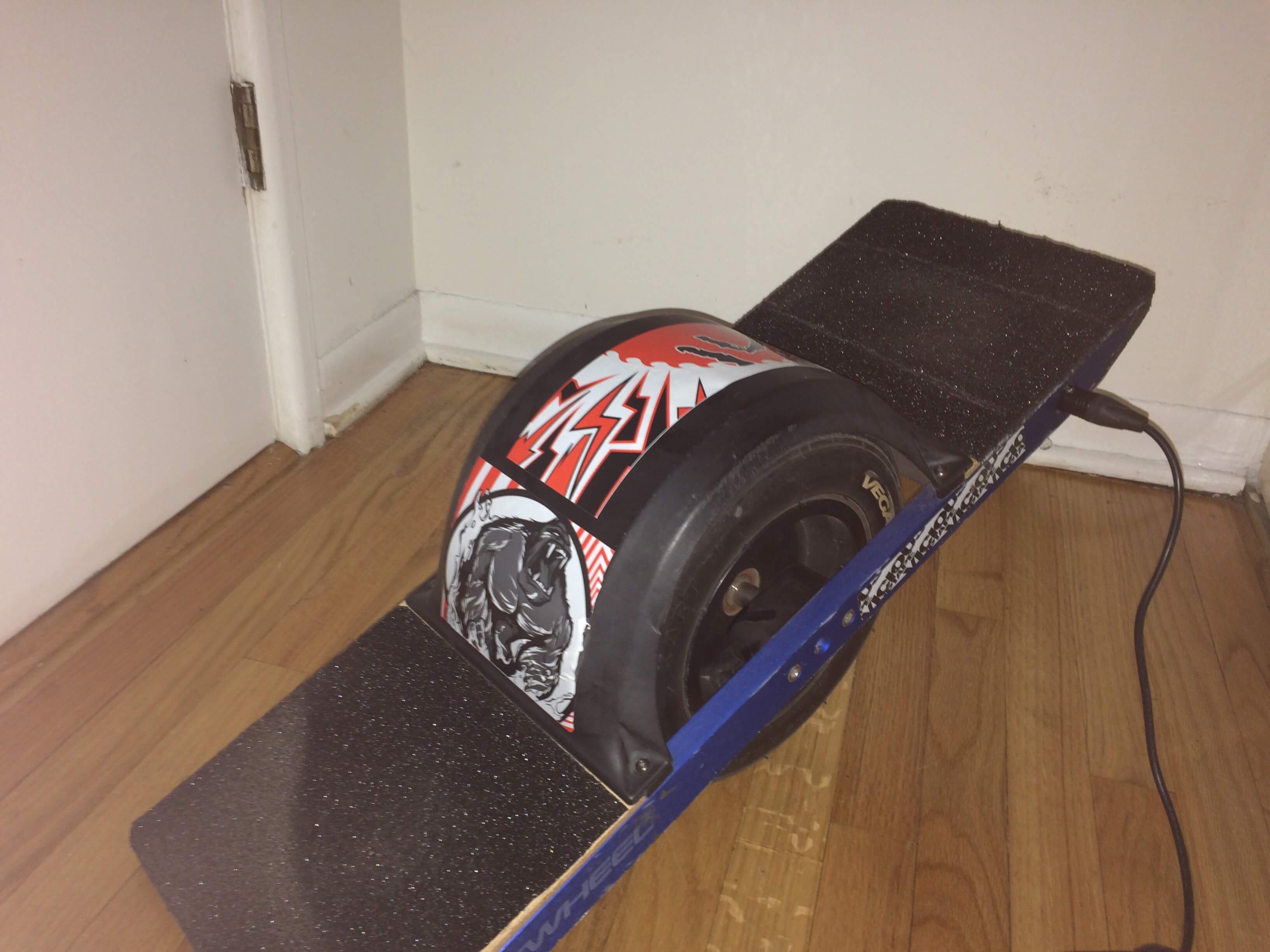

    @Carlo - thanks, but I can't claim credit. That paint job certainly is curious. This is my second OW I picked up used on Ebay. Apparently this one was custom-painted for the customer by FM as part of a special promotion (everyone please don't start asking FM for custom paint jobs). Honestly, my other (blue) one looks much better IMHO. I don't mind the green though since I'm 100% about the riding and not looks.
    SkateFirst.SamT 13 July 2015, 18:42 UTC
    I saw this one when it was on ebay. always wondered why it was painted green with that design on the side.

    lynnpreston - are you using Vicious coarse or xtra-coarse? Just curious and also, how's it been working out for you since the switch?
  • lynnpreston 7 October 2015, 21:04 UTC
    I'm not sure. Package doesn't say. This is what I have:
    http://amzn.com/B00PH4DDFS
    I love it. It grips a lot better with wet sandy feet or shoes. I ride barefoot on it all the time, and it doesn't bother me at all. It doesn't look at good as the FM branded tape, but the tradeoff is well worth it for me.
    Chance2ride2 7 October 2015, 21:58 UTC
    Thanks, that looks like the normal/coarse one. I think I'll do this mod right off as I'm used to the tackier/stickier grip of Jessup, Madrid Flypaper and Vicious and the 1W stock grip looks pretty low/small-grain. I think i'll use 2 colors to differential the sensor side from the non.

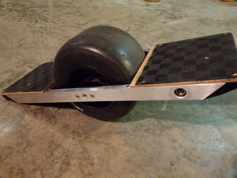

    Look up "My sensor mod". I regripped and the sensor responds better
  • Zluz 27 January 2017, 05:13 UTC
    The original grip tape comes off easily. Just be careful when pulling it off to not damage the sensor while you're at it.

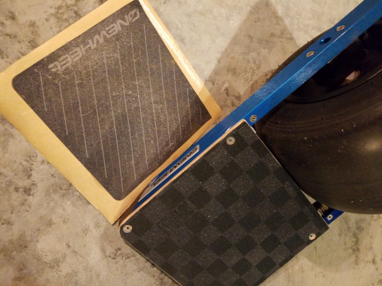

    Is the OW grip tape attached to the "clear plastic" or is the clear plastic part of the tape, I pried up like 1/4 of a inch and notice that the tape appears to be attached directly to a clear piece of plastic do I need to remove that as well? Does anyone have any pictures on what I should see after the tape is removed. Just dont want to damage the foot pad. It looks like the grip tape is attached to the plastic and the plastic is attached to the wood is that the correct order. photos would be very helpful.
  • slydogstroh @tony420121 16 March 2017, 16:39 UTC
    @tony420121 Yea! In this sub. See above.

    @slydogstroh Did you apply the tape directly or did you add a piece of paper/cardboard between the sensor and the grip tape? (like in the photo with the green onwheel)
    ltl 16 March 2017, 17:32 UTC
    I was reluctant to remove the grip tape, since the sensor is working perfect. I just cut to strips of vicious grip tape and taped them beside the old tape so under my heel and toe. That is also an improvement for the grip.
  • slydogstroh @tony420121 16 March 2017, 18:17 UTC
    @tony420121 definitely cut out the paper the grip comes attached to and place it between the sensor and vicious. That protects the sensor from the stick material.
