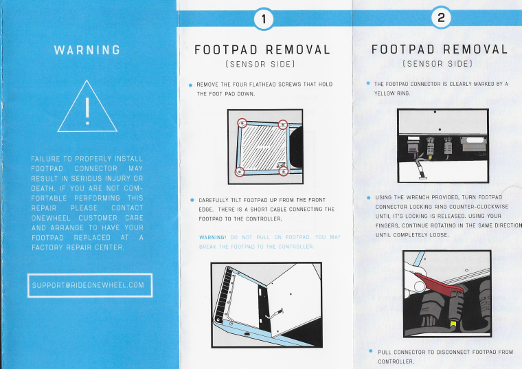

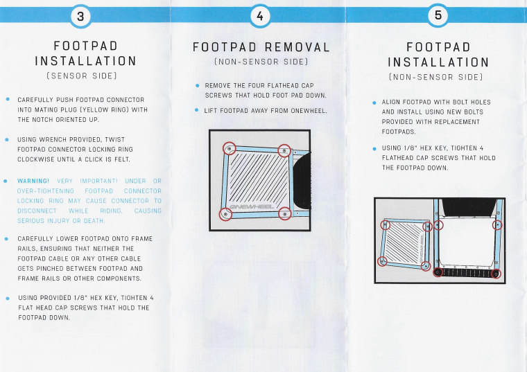

    1woman1wheel 14 November 2016, 16:03 UTC
    Hey folks, just wanted to give an update! My board started working again, so instead of having me ship it in, FM gave me instructions to open it up and check the sensor connection myself. Feeling pretty boss and the board is riding great so far! Another big thumbs up for @Future-Motion tech support!

    What they sent me looked like it came out of the manual. I was told to detach and reattach the connectors on the sensor footpad. Let's see if these images work.
