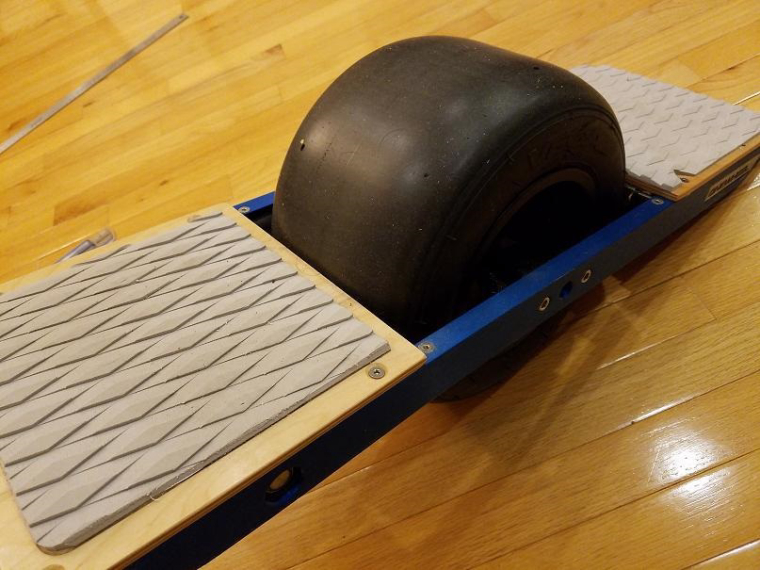

    You just put them on top of the existing footpads? Not taking anything off?
    r1alvin @GoneProBro 23 November 2016, 16:11 UTC
    @GoneProBro Do the traction pads affect the activation of the footpad sensors underneath?
    Like the idea,,,but I like to ride with my rear foot up almost against the fender on my OW,,,so I would probably move that kickpad slightly more towards center of pad on the OW,,,,
  • thegreck @GoneProBro 23 November 2016, 17:22 UTC
    @GoneProBro This is rad! I'd totally consider doing it, but I'm waiting for your reply to the sensor issue. Does it or does it not affect the sensitivity of the sensors?
  • GoneProBro @thegreck 23 November 2016, 17:41 UTC
    @thegreck sorry getting a few repeat questions. (& was camping overnight) Absolutely no noticeable effect of front foot sensor. Only thing you will notice is your foot feels stuck to the new pad.
  • GoneProBro @r1alvin 23 November 2016, 17:42 UTC
    @r1alvin no not at all. Works brilliantly.
  • GoneProBro @Polle 23 November 2016, 17:43 UTC
    @Polle yes peel off stock grip tape & replace with deck pad.

    Well mixed review on front kick pad. Traction and foot lock is out of this world.. However at the expense of a slight delay in front foot sensor shut off. Its around a tenth of a second. I did not experience this with the grey sup traction pad that i initially tried. This could be a result of the new traction heel kick or possibly I warped the plastic plate covering the sensor when I slightly warmed it to install the trac top. My take away.. Rear trac pad with heel kick is a huge improvement in foot lock, traction and noticeable drive to the back foot. Front is even better, but I am reluctant to reccomend until I find a solution that has zero effect on front sensor. I will continue to tinker and will solve this. That being said, who's in for a single track session or two tomorrow. Im game.

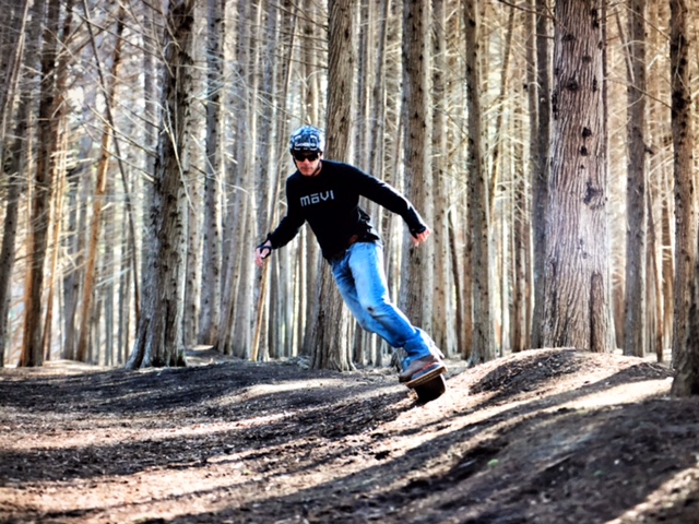

    This is that coastal loop that I have been riding. Lots of trees, single track and berms. 0_1480017598748_Brap.jpg
    fabuz 1 Reply   Reply Quote 4

    @GoneProBro WoW! Awesome pic and spot!

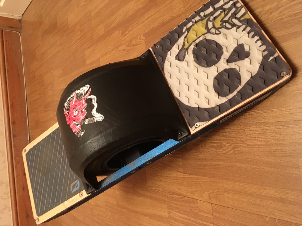

    Zen.Potatoes @GoneProBro 3 December 2016, 22:20 UTC
    @GoneProBro Great idea dude... Only done the back end today but so far feels great and the back foot feels so much lot more planted...
    GoneProBro 1 Reply   Reply Quote 5

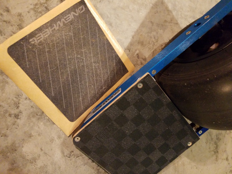

  • Zluz
    Zluz 14 December 2016, 07:37 UTC

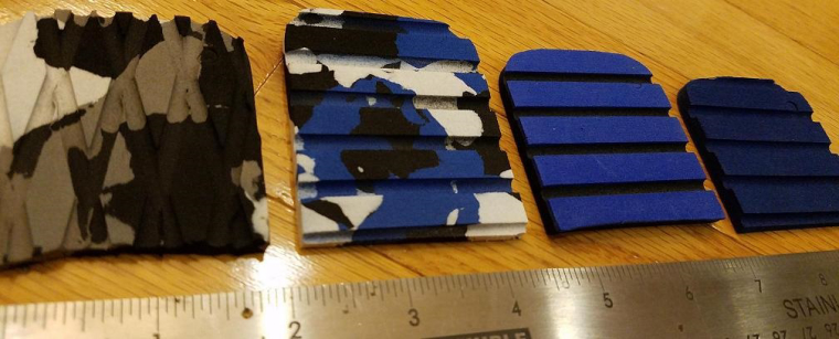

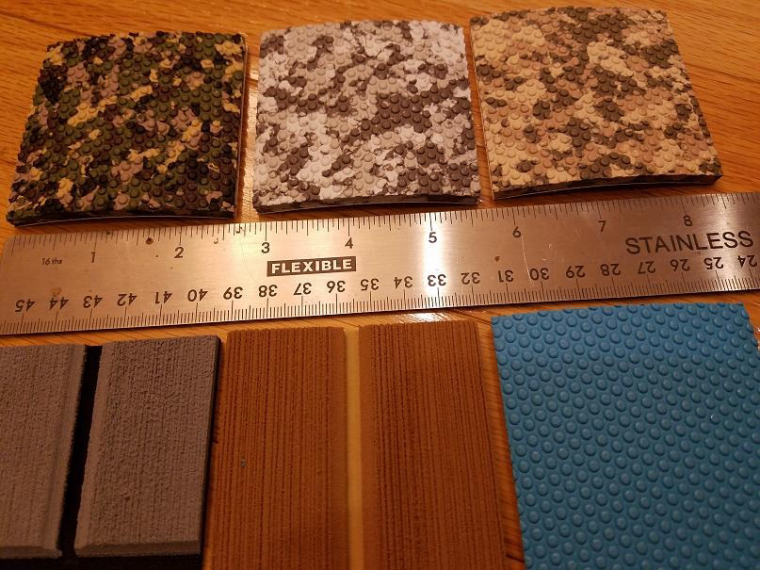

    This post interested me enough to do some research and see what I could come up with. I thought I'd share what I found.
    The idea to add a textured traction pad seemed to make sense if the board may be bouncing around beneath you. I found some good stock on ebay and two companies that looked promising.
    The two manufacturers were:
    • Hydro-Turf: http://hydroturf.com/pwc_matcolors.php
      Decent groove-cut options, decent patterns.
      ![0_1481700931255_6954_2.jpg](Uploading 100%)
    • SeaDek: http://www.seadek.com/
      Seemed promising, great buying options, but the imprinted texture is just too fine.
      ![0_1481700969549_0524_2.jpg](Uploading 100%)
      They both sent samples.
    I ordered a sheet off ebay also. I tried it out and I was happy with how it felt if I was barefoot. It also softened landing on the board when jumping etc.
    These would be the foot pads I put on if I take my OW to a beach.
    In the big picture though, I did not feel like this improved foot traction.
    ![0_1481700986082_4090_2.jpg](Uploading 100%)
    I really wanted to try some real surfboard/SUP traction pads but they have not arrived. I am sure they would work better. I am not sure how they would feel barefoot.
    These might be best for a rough trail.

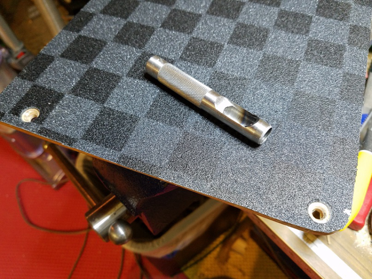

    The last change was simply to go back to grip tape. I had no problem removing the original OW pad and adding some basic skateboard grip tape. This stuff normally comes in about 3'x9", sometimes larger. 9" is fine if the tape is applied vertically. I used a leather hole punch to cut out the holes for the screws. It went on without any problem. I plan to seal the front foot pad first to waterproof the switch.
    ![0_1481700997077_9033.jpg](Uploading 100%)
    ![0_1481701004683_1232_2.jpg](Uploading 100%)
    (I hope all those pictures uploaded .. forum newb, here..)
  • Zluz
    Zluz 14 December 2016, 07:44 UTC
    Forum seems to require some JavaScript that is blocked. Interferes with images.
    I'll re-post images here..
    Hydro-Turf product:
    SeaDek product:
    Traction pad material off ebay, test-installed:
    Grip tape installation, showing leather punch:
    Grip tape installed:
