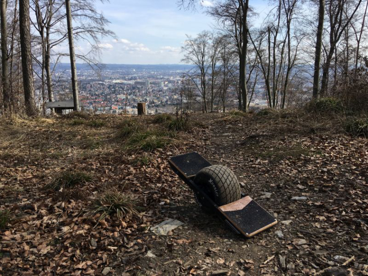

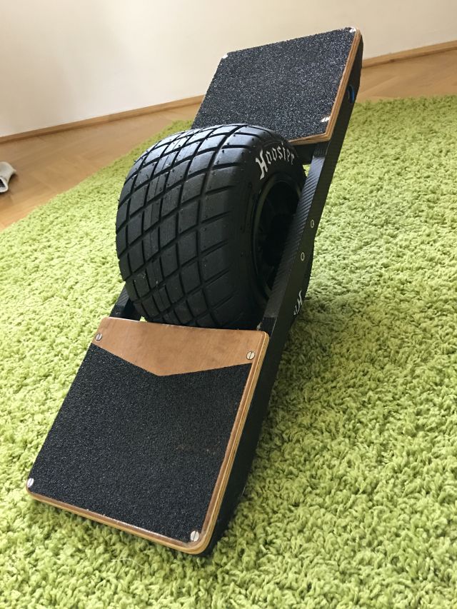

  • cr4p 24 February 2017, 16:42 UTC
    finally i also did it!
    when i first tried it, i was only able to pump to around 15psi, before it would rubb on the footpads. the ride was only about 30% as agile as i expected - propably because of the low psi that did not shape the rounding as it could be and on the other side allowing to much squeezing when carving on the edge. it still felt better than the original tire, but i was a little bit disapointed, because i felt like there would be more potential.
    however, i consoled myself by looking forward to the advantages in offroad riding (which i can´t do yet, because winter isn´t gone and so it is too muddy).
    when I recharged it and was ready to go for the second ride @SeeTheInvisible called on the phone, asking about the first ride. i told him that ot still feels better than the original one, but still i am a little bit disapointed because of the unused potential out of the low psi. he encouraged me to sand away a some material of the middle of the tire to be able to put more psi into the tire.
    i was not in the mood to do so, but when i went down for a ride, i changed my mind and went to the garage to give it a first try.
    in fact i was able to pump it up a little bit more, after removing some material from the middle section of the tire.
    i went out for a second ride and immediately felt the improvement. it was more agile as before and more playfull to ride. it was a lot of fun, but i decided to return at the half of the way to remove some more material.
    the 3rd ride was already close to what i had initially expected it to be in terms of agility!
    alltough it is much to early for any kind of wrap up, i already love it. it is more playful, it feels more agile and besides that the look is cooler;-)
    but i am still looking forward for the offroad thing and i also do think that i will continue to remove some material (currently i am around at 18-19psi)
    thanks @no for providing the inspiration within this thread and thanks @njcustom for the helpfull tire change tutorial!

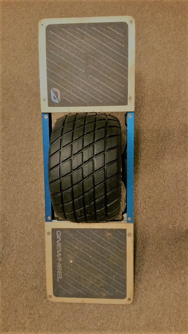

    fruitygreen 25 February 2017, 09:01 UTC
    Hitting the sand tomorrow morn. This time with threads. I hope it will perform better than the smoothies.

  • cr4p 3 March 2017, 12:07 UTC
    first offroad ride and i still love it!
    thanks @No !
      Reply Quote 9 1 Reply
  • Earthpilot 3 March 2017, 20:32 UTC
    @cr4p Nice shot, where is that?
