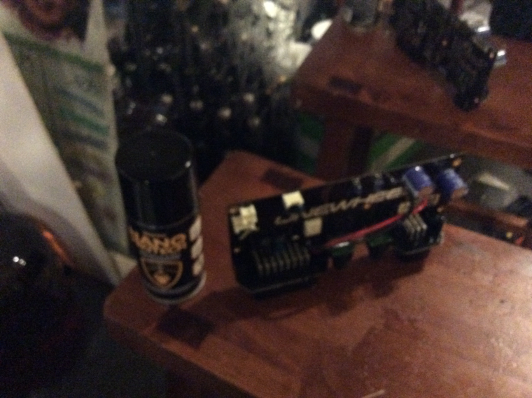

					CcocoabeachW1 @cocoabeachW1 10 December 2016, 06:17 UTC
@cocoabeachW1 ok - nano protect on the ctroller board and flex seal around the connectors
After inspecting the battery case it is actually not bad - I just silicone around seam line of the case and the connector - also plugged up the hole with silicone so not much else for the compartment. Will finish up the controller tomorrow , then will reassemble. The only concern I have is the harness wire going into the wheel it self. Need to sleep on that one.
					CcocoabeachW1 @cocoabeachW1 11 December 2016, 20:03 UTC
@cocoabeachW1 going to pott the controller board to tomorrow
Also plan to use dual wall adhesive shrink wrap on all of the connectors and harnesses to make them water tight. Only thing to figure out is the harness that into the wheel assembly. Going to use shrink wrap on the harness but there a gap where it enters the wheel. Not sure of the best solution is for that . If I can figure that out there would be no problem dunking it in The ocean should it halon, or riding through large puddles. Any ideas from the forum? -
