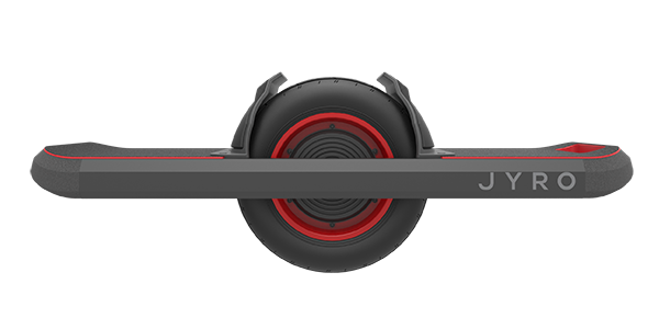

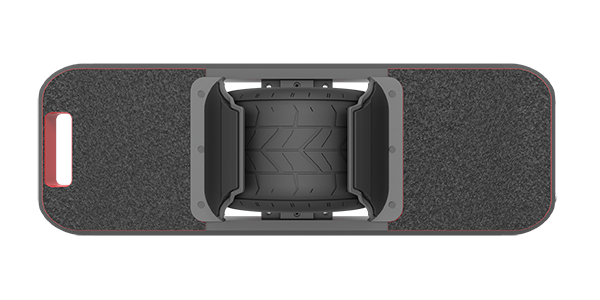

    braswell 14 February 2017, 04:30 UTC
    @No you gotta post video of this beast already! I'm also curious on how the mini fenders are holding up and if your thoughts have changed.
    I love the look as well, even the copycat "Jyro" seemed to go this route. I'd love @njcustom opinion on it too. I remember you considered making a set using brushes or something.
    Just love the naked look much more than fender. But I want clean pants :)

    @braswell someone on the forums tried it with one of my fenders and I don't believe it worked.. that's what's great about the magnetic feature, you can install it in the blink of an eye..
    No 1 Reply   Reply Quote 0
    No @njcustom 14 February 2017, 06:17 UTC
    @njcustom said in OW Overhaul Project: Concave Footpads MK II, Aluminum Footstops, 3 piece fender with BBQ Paint:
    Yea, that was me lol
    @braswell the main issue with mini-fenders is that the rear-facing fender takes the debris that typically ends up on the footpad or shoe...and deflects a portion of it directly against your front leg. Looking at that JYRO image, notice the angle of the mini-fender, that's the angle debris will fly, not all of it, just some. Essentially it trades a dirty shoe/footpad for junk randomly tapping against one of your legs. That being said, the forward-facing fender works perfectly at keeping junk off your forward shoe/footpad. In the end, it ends up being a compromise that's only slightly better than no fender at all but looks cool. Regarding the brush idea, I decided not to follow up on that because the brushes would be full of worm meat and mud after a couple rides.
