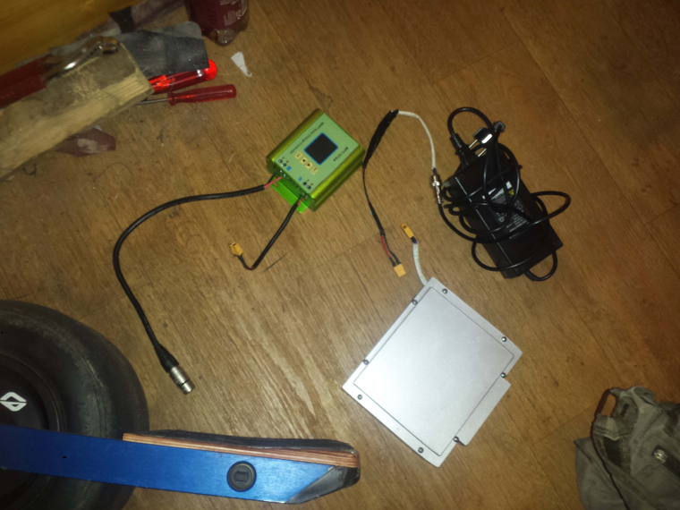

    cr4p @fruitygreen 17 February 2017, 08:39 UTC
    @fruitygreen said in Portable Power Supply / Pure Sine Inverter:
    The boost controller cr4p used appears similar/or same but different brand. Anyways this setup is a lot more efficient physically and electronically than an inverter type charger.
    i would not recommend the one i used. i have two of those. alltough it works and you can use it to charge, it still is slightly beyound it´s limits. the result is, that it gets quit hot and you have to slightly cool it, and that it takes about 50 minutes for a charge (because it does not deliver the full 3.5amps.
    T F 2 Replies   Reply Quote 0

    timvdp 14 April 2017, 22:11 UTC
    just 1 xlr plug
    and 1 black red conector for the battery

    Wall outlet --> DC power adapter --> DC female barrel to XT60 --> female XT60 pigtail connector --> solar power booster --> male XT60 pigtail connector --> battery
    Charging OW
    Battery --> male XT60 pigtail connector --> solar power booster --> female XT60 pigtail connector --> XT60 to XLR converter --> OW
    Notes
    The downside to this approach is the solar booster is used for both charging the OW and the battery. That means changing settings and possibly wire connections. I don't know where to find a "native" charger for the battery though.
      Reply Quote 2

  • Snurfer 16 April 2017, 12:55 UTC
    Has anyone thought of using a Ryobi 40 Volt 2.4 Ah High Capacity Battery with a solar booster to charge the OW?
    Would it be possible?
    I have three of them laying around for my mower and weed trimmer.
  • noahsw @markdjr 16 April 2017, 14:01 UTC
    @markdjr said in Portable Power Supply / Pure Sine Inverter:
    Can we get a post on how to wire the xlr please?
    My thought was solar power booster --> female XT60 pigtail connector --> XT60 to XLR converter --> OW

    wr420 @noahsw 22 April 2017, 14:11 UTC
    @noahsw That will work. You should get 4+ charges out of it.
    sonny123 @wr420 25 April 2017, 20:43 UTC
    When charging through the solar charger, does the light on Onewheel stays on as opposes to flashing when using the Onewheel charger?
    wr420 25 April 2017, 20:56 UTC
    @sonny123 - the light on the ow acts the same with the solar charger as it does with the ow charger. The more it's charged the longer the light stays on each flash cycle.
    sonny123 @wr420 25 April 2017, 21:07 UTC
    @wr420
    Thanks.
    I did set it at 58V and 3.5A but my Onewheel is charged and it's freaking raining out.
    Anyway, I made a quick video and it's uploading.
    Will post it when done.
    Hey thanks for recommending that thing.
    1 Reply   Reply Quote 7

    So the ultracharger can be completely replaced with the solar charger? assuming we swap out all the proper plugs? Would there be any disadvantage? it's significantly smaller and cheaper...
    Snurfer T 2 Replies   Reply Quote 1
  • Snurfer
    Snurfer @No 25 April 2017, 23:47 UTC
    @No so long as your power source is lower than 58v, such as a battery pack or solar panel. I don't think you could use 110v for example.

    sonny123 @noahsw 26 April 2017, 14:02 UTC
    @noahsw
    It was just an error.
    Once I ran it down to 90% and tried again,
    it charged the same way like the Onewheel stock charger.

    owBeez @sonny123 27 April 2017, 08:27 UTC
    @sonny123
    the MPT-7210A seems to be the so far best approach, there is a detailed review on https://www.youtube.com/watch?v=rC4rF62CHKY -
    looks like it can take anything > 8V DC as input! So could be used to charge from a car battery as well.
    Also there is a way to configure the charger to start automatically once input power is supplied
    sonny123 28 April 2017, 17:47 UTC
