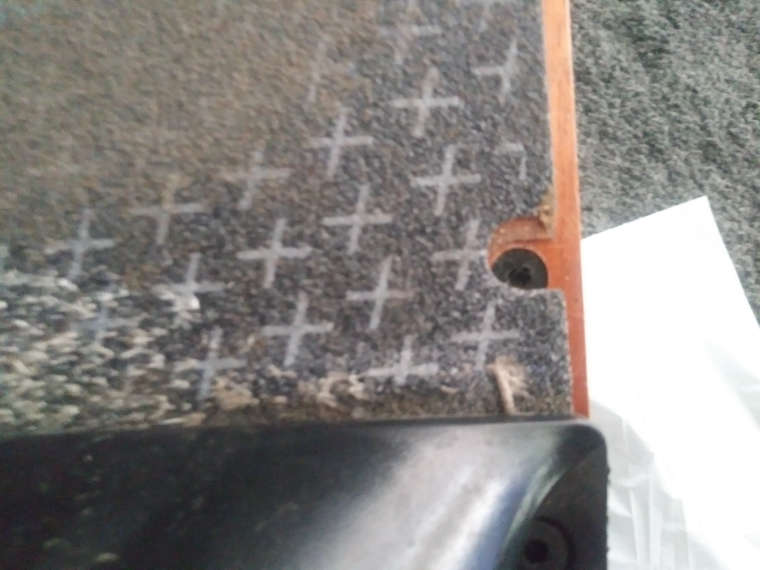

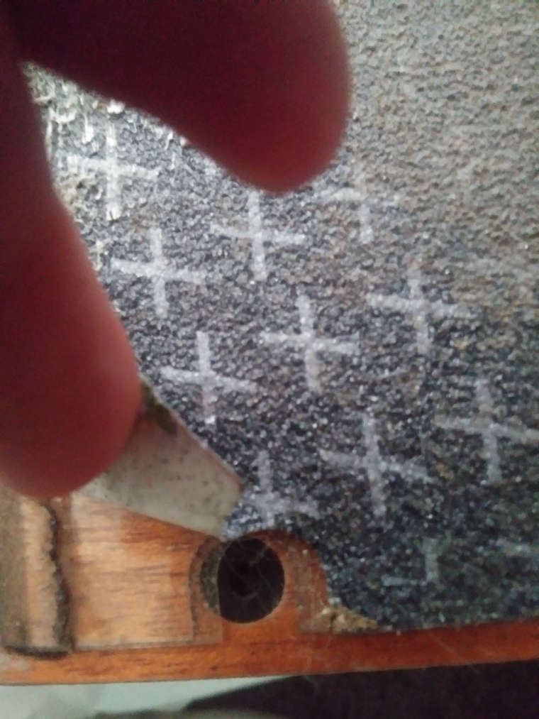

  • snwbrdwndsrf @Snurfer 7 March 2017, 17:04 UTC
    @Snurfer those pics are actually of my board. I do use a fender, so lots of water builds up along the edge (you can see the dirt line where the fender edge lays against the grip tape). I know the wood won't handle the water very well in the long term and will apply some sealant soon, but having the pad lift and expose the sensor underneath after only 3 days of riding is disappointing. I have emailed support to ask for a warranty replacement.

    Reptile @njcustom 4 September 2018, 23:16 UTC
    @njcustom Hey man sorry for a reply on this old thread but doesn't replacing the grip tape void the onewheel's warranty? Im having some slippage but not sure if I ought to be concerned or not. Functionality seems fine so far but one nasty fall is enough to have me wanting to avoid another.0_1536102969001_0904181644b.jpg 0_1536102985602_0904181650a.jpg
