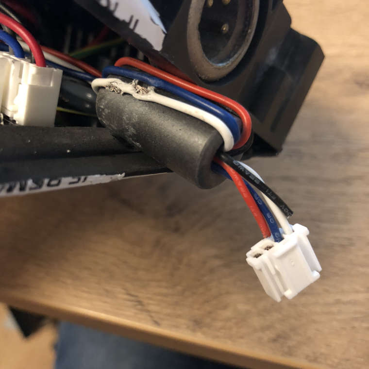

    roninXpl 4 October 2018, 19:40 UTC
    This is how my cables look like. I can't see how this is not a design flaw that could be easily avoided. Definitely not built like a tank.
  • tomfoolery @roninXpl 4 October 2018, 20:53 UTC
    @roninXpl wow! That’s insane. Are the black and white wires supposed to be in that connector as well?
