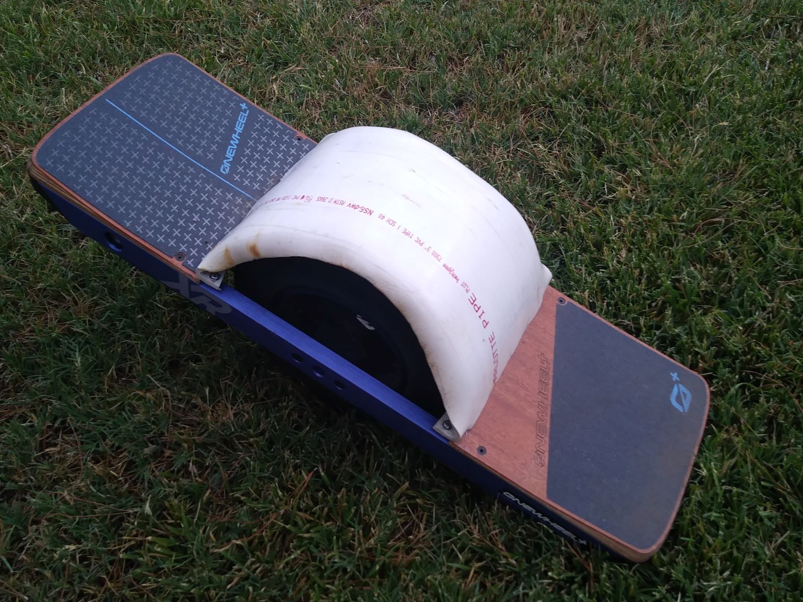

    I've never tried it with PVC, but with acrylic sheet, you can heat it in the oven at around 200 degrees, then bend it on a form.
    You might want to investigate bending it after doing the initial unrolling with a heat gun from pipe-form to sheet-form, then heating in an oven, then re-bending over your form.
    Not sure concerning the risk of fumes off-gassing from PVC, so do a little research, and use good ventilation (when the wife's not around).

    Tried that exactly once. The wife "FIRMLY" informed me that there would be no more heating of PVC inside the house.
    It does out gas some rather unpleasant chemicals. Best to keep this an outside activity.

    Pulled the ugly fender off the board last night and did a little more trimming and molding. I took about 1/4" off both sides trimming up the width and then rounded over the edges.
    So now I have version 1.1
    While not any better looking than before, it is a bit more functional. The issue that I was running into with the ver 1.0 was that as I carried it around the 1/4" edges that were hanging off the side rail and the square edges of the rest of the fender would often rub or catch my leg. Not painful of anything, just annoying.

    @Sponge315 please for the love of god, paint that thing... shape is looking good though

    Dude, that schedule 40 is strong enough to support a keg - I think you may be on to something here.

    It isn't quite right just yet. So there is still a little heat gun in its future.
    So the stickers will have to wait just a while longer.
    I do have a few already waiting.
