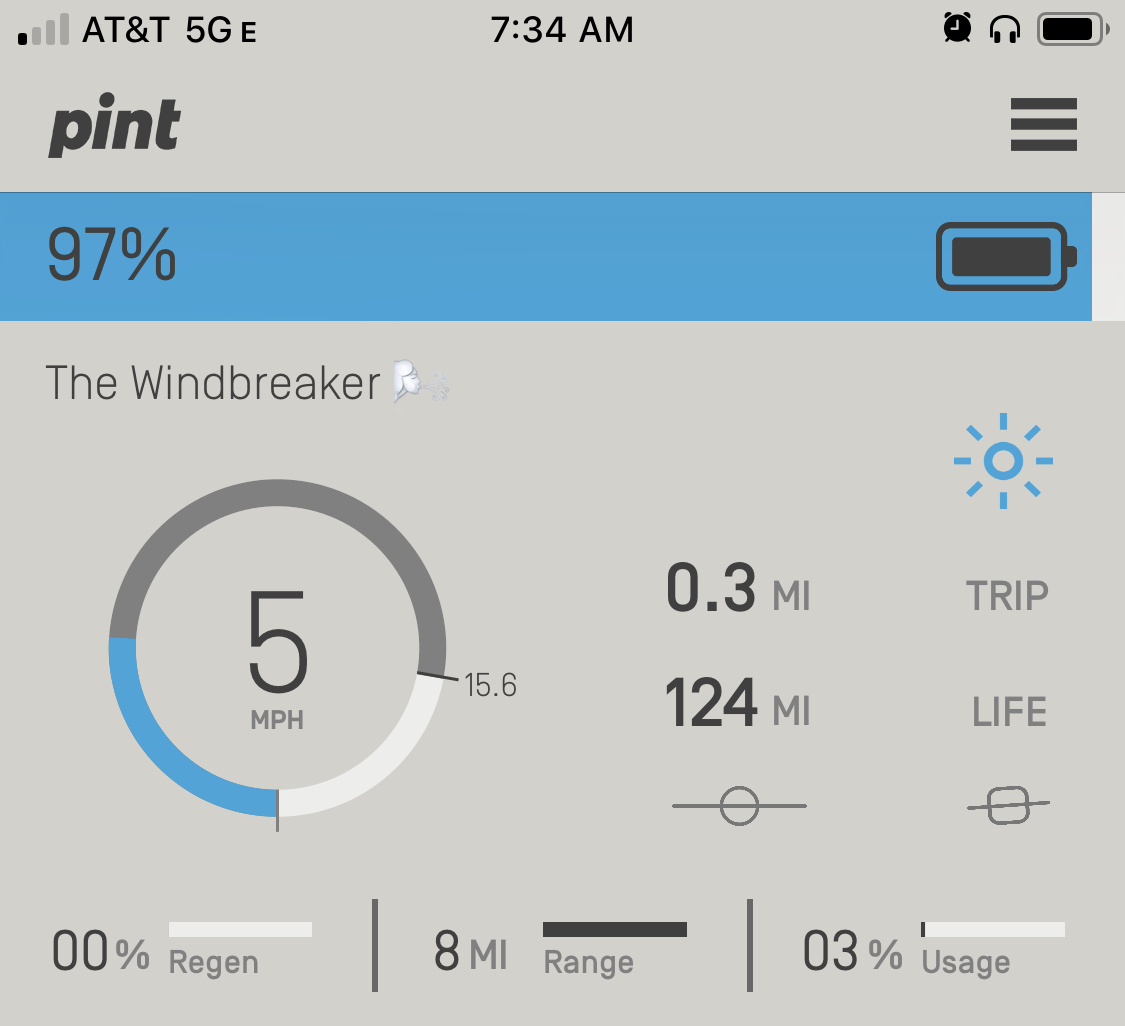

    Again today, I hit 15 several times but my top speed refuses to update. Guess it really doesn’t want me going that fast!
  • a_onekatie

    Okay this is where the issue is really pissing me off. Parking lot ride this morning, I was getting major, noticeable pushback the whole time. To the point that I actually thought maybe I’d accidentally switched to Redwood without realizing. Take out my phone to check and no, I’m in Pacific, and the speed readout says 12. 12!?!?!? WTH? Holding the phone in my hand still, I reach the end of my ride and begin to slow down, and low and behold the app suddenly updates to this:
    So I guess I just gotta take whatever the app says with a grain of salt? 🤷🏼‍♀️

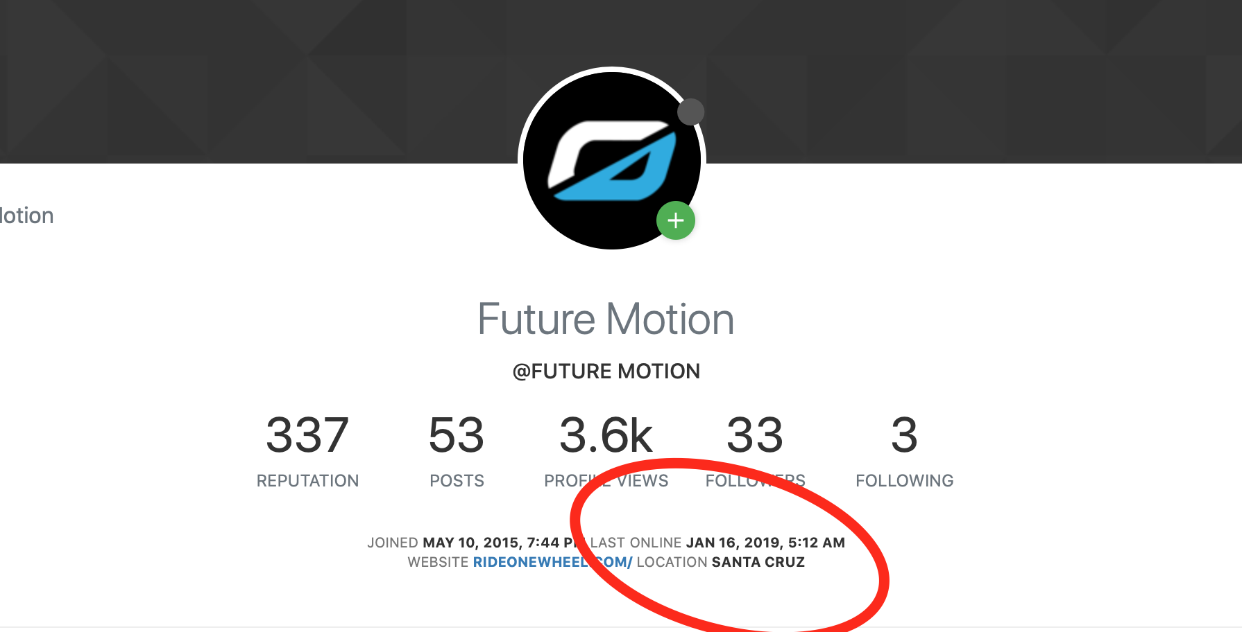

    I don't foresee any resolutions to any of our issues until they're directly reported to the CS link provided above.
    If the app wasn't designed to be constantly connected, then how do they expect the ride logging to work? Lol.
