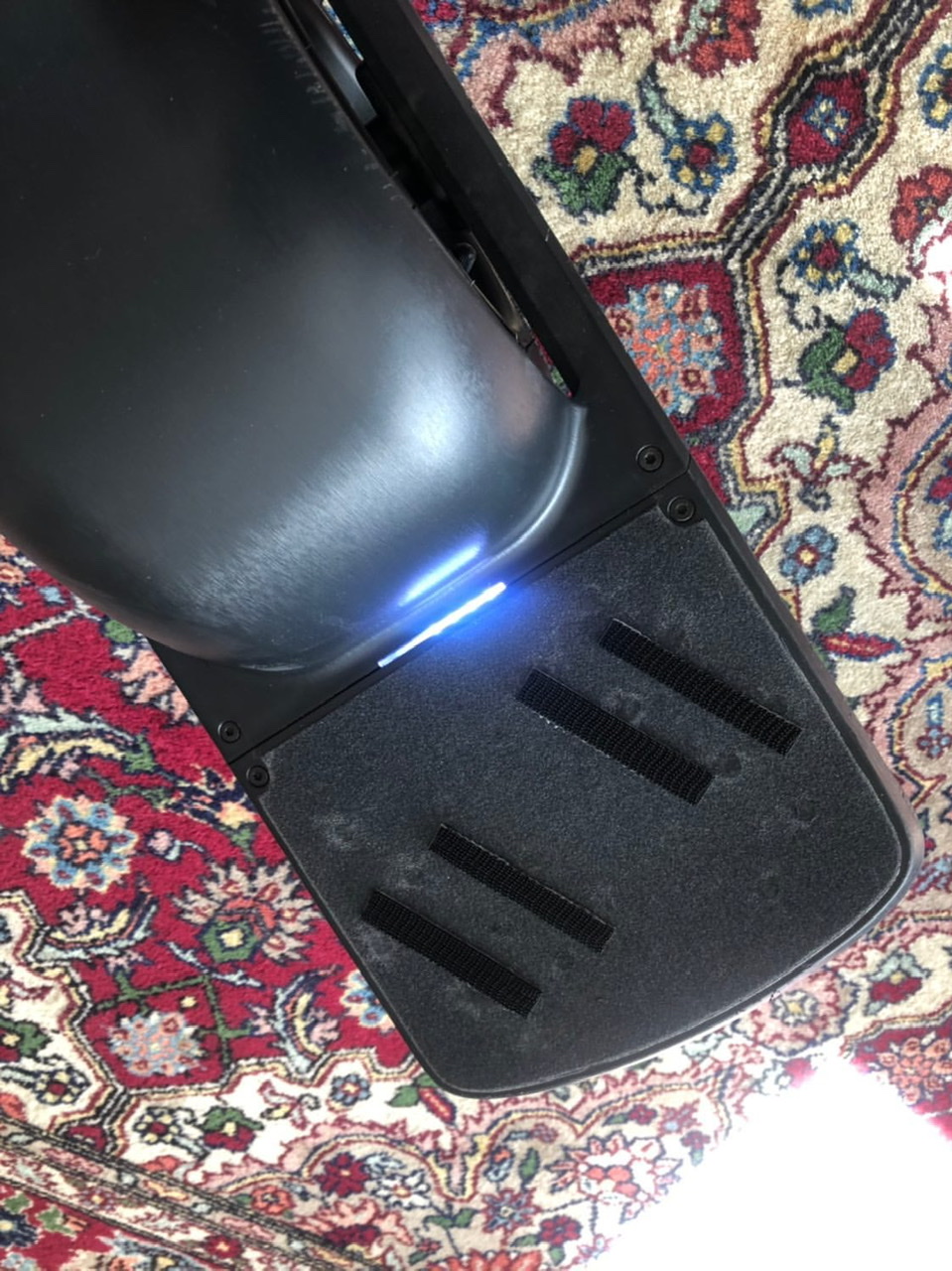

  • ShreddieMcskate
    ShreddieMcskate 26 September 2019, 10:55 UTC
    Dude 2 small felt pads on the sensor and it’s fixed for me..give it a try...My buddy from Germany actually put two strips of Velcro on his..
    S 1 Reply   Reply Quote 1

    F814A5BC-B871-4ACE-9E30-89955C99DF4B.jpeg 7AE1FC72-4F97-480A-8815-69B9AC6DBA1C.jpeg
    LidPhones @ShreddieMcskate 26 September 2019, 13:32 UTC
    @ShreddieMcskate
    I love the ingenuity in our community. Great Hacks for sure and it solves the sensor contact issue brilliantly....

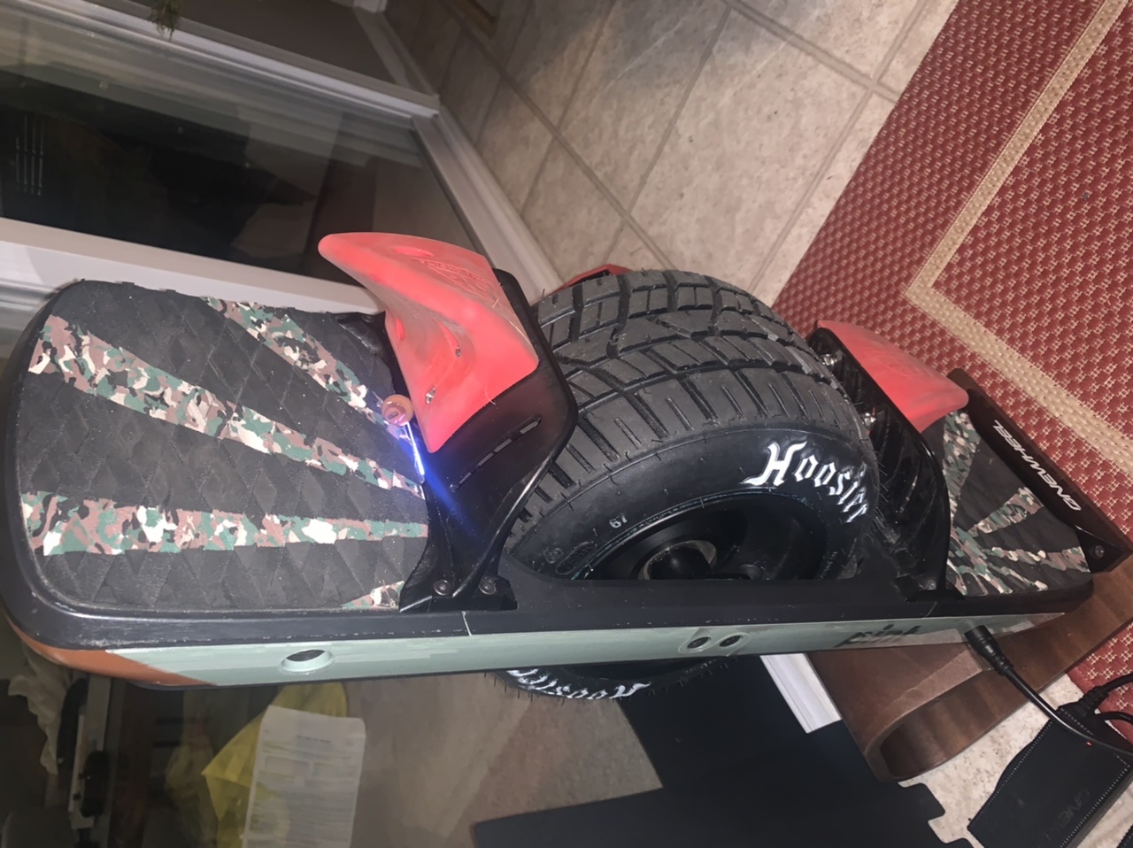

    speedracer @ShreddieMcskate 21 December 2019, 21:21 UTC
    @ShreddieMcskate are those round pads right in the center line between the sensors?
    ShreddieMcskate 1 Reply   Reply Quote 0
  • ShreddieMcskate
    ShreddieMcskate @speedracer 22 December 2019, 16:03 UTC
    @speedracer 9720BCCE-92BB-4BE2-8CA1-CC3D66E5D48F.png CB7EB881-E1D2-46F3-92E6-352DAE3272BD.jpeg
    The first picture is how I used to have my board set up but I ended up putting pro ride traction pads on it and it’s been amazing!! No sensor problems at all👍🏽
