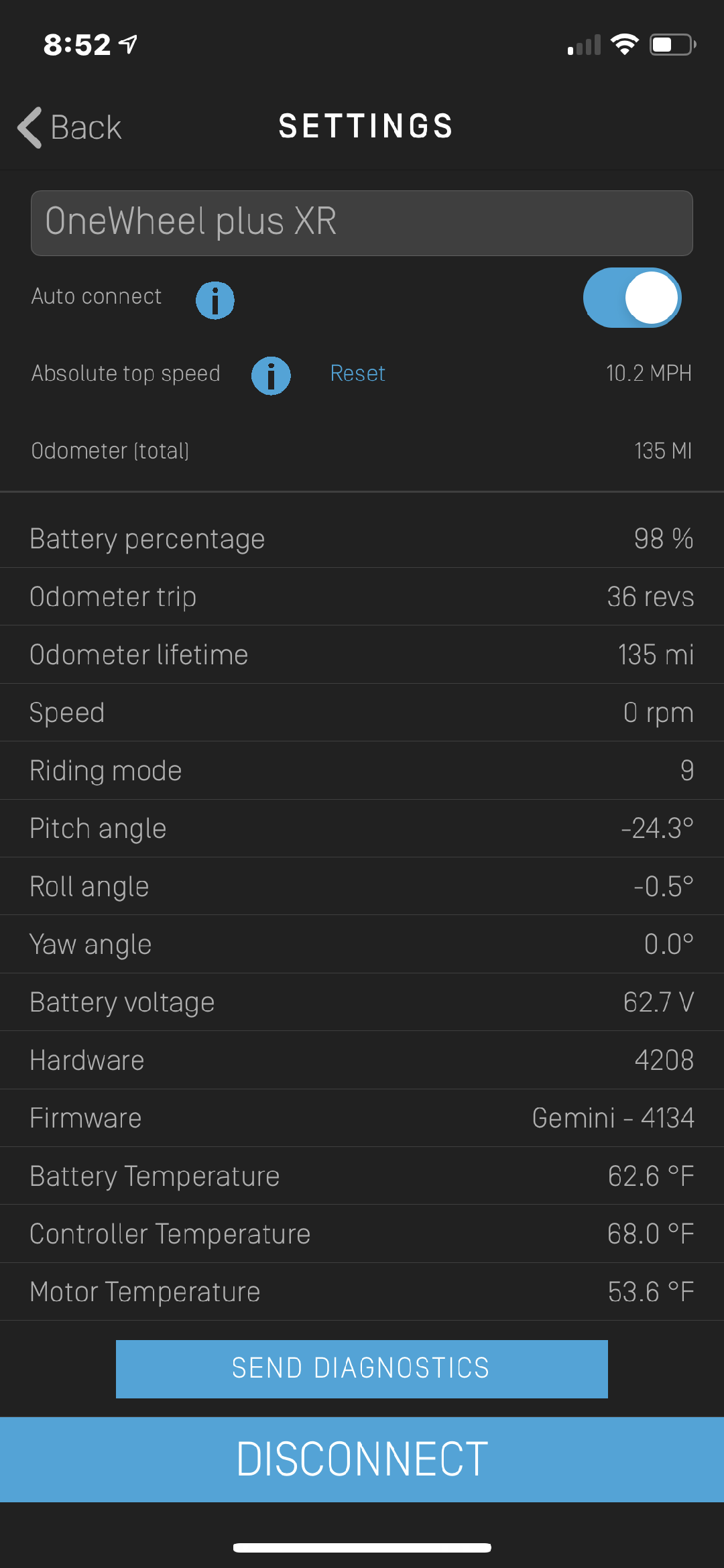

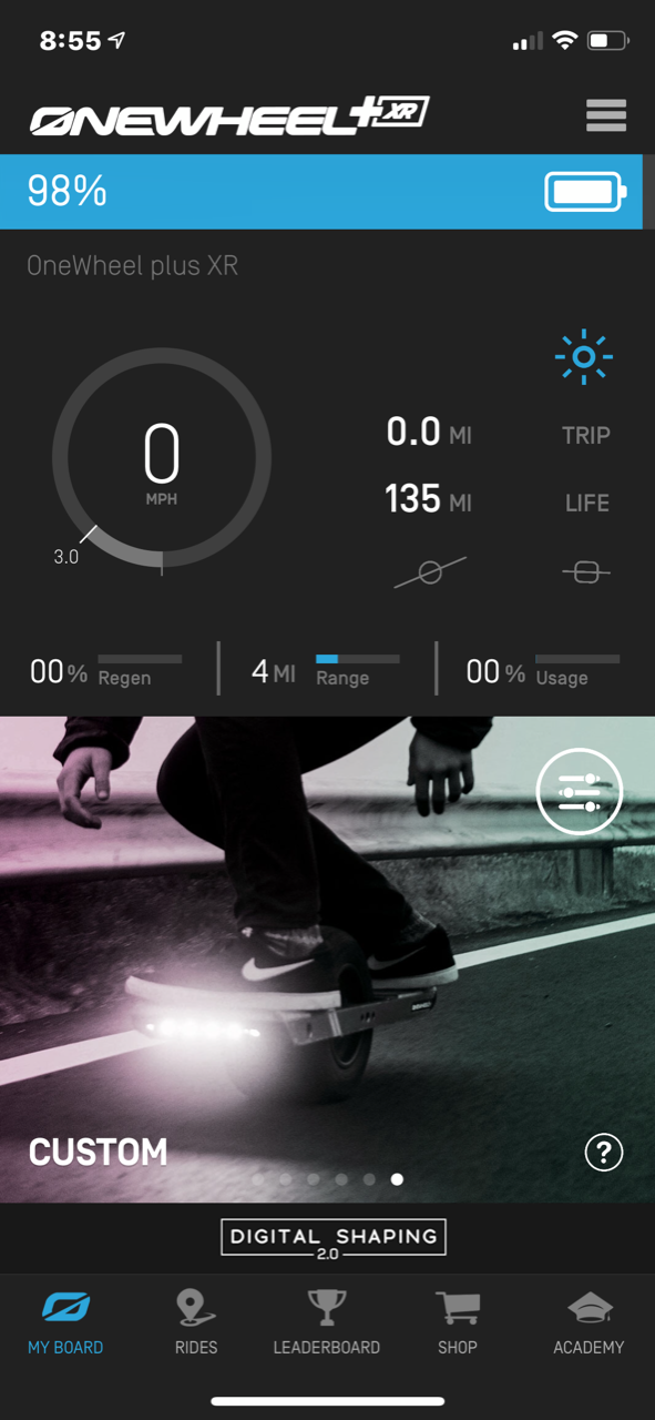

    Well I left the wheel on the charger on the charger for over 72 hours with no change.IMG_5354.png IMG_5355.png

    Contacted OW. They stated the only thing left is to send the board in at my expense.

    @MDMason i have an android and downloaded the Onewave app from github. It gives you the individual cell voltages. If you don't have an android, maybe a friend does?

    My board only has 135 miles. It is out of warranty. I'm going to try and run it down to zero a couple of times before I decide to send it in. This incident doesn't give me much confidence in the quality of the board.

    Well I finally heard back from Future Motion after I sent them the board with only 129 miles on it.
    Thank you for your patience and my apologies for the delay. I received the full evaluation and quote cost for your board from our repair techs today.
    Your battery is found to not be performing up to our specifications and is in need of replacement. This was causing the decreased range issues you were reporting.
    Since your board is no longer within the 6-month or 12-month warranty period, the total cost to get your board back in tip-top shape is $410.69. Below is a breakdown of the cost:
