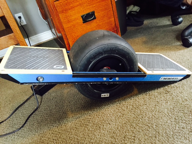

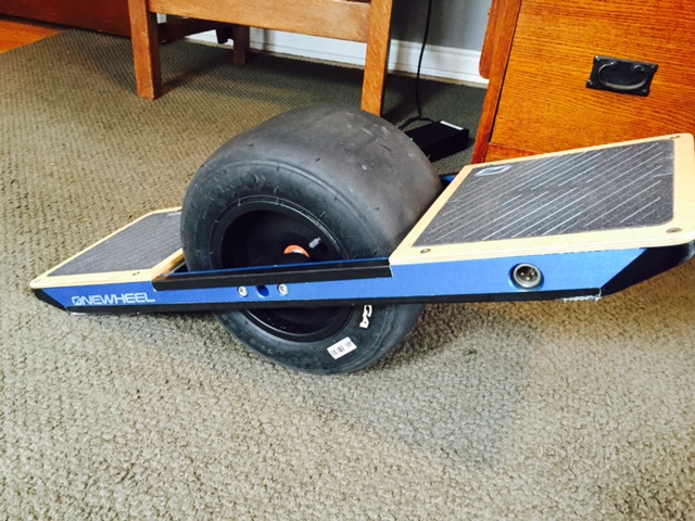

    Here's where I put the Gorilla tape on the frame rails. The damage you see is on the tape only. I will likely replace the tape every couple weeks or so... You can also double up the tape for extra protection. FullSizeRender 3.jpg FullSizeRender 2.jpg

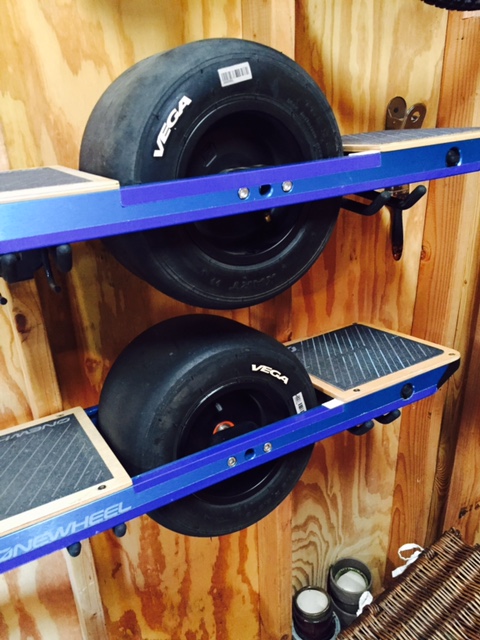

  • MichaelW 31 July 2015, 23:27 UTC
    @818 @DVO @Wayne @Docblock @forzabucks @veryous @J-glide @OneWheel-support Ducktape brand in blue protects nicely. Had both my boards for a month and they still look sweet! I know some people think they look better banged up but I always want to keep it nice if I can. Better resale when OneWheel 2 comes out ;) Also, this tape looks pretty good don't ya think? Better than grandma's couch with plastic on it?

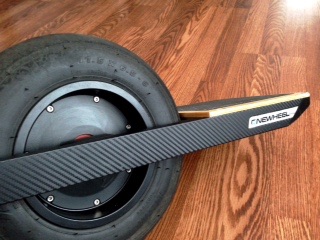

    Banjo 3 September 2015, 06:17 UTC
    Nice! Thats the first mod to OW that Ive seen that actually makes it look better than the original.
    Please explain mate! The more detail the better.
  • MichaelW 3 September 2015, 07:09 UTC
    Holy shit @J-glide! Can I pay you to carbon wrap my boards?! Bad ass!!
  • utsu @J-Glide 3 September 2015, 09:32 UTC
    @J-Glide uhhhh what! Did you do the wrap with a heatgun? like this-https://www.youtube.com/watch?v=3LhMxcHUKAw
    What a beauty.. Do you have to disassemble the OW to get the wrap on correctly? I'm terrified of taking it apart.
    Brutha Man @J-Glide 3 September 2015, 12:54 UTC
    @J-Glide where'd you buy the material/how'd you put it on??
    You describing/showing off your method would be a great video idea
    ThatGuy 3 September 2015, 15:37 UTC
    Is it removable/replaceable when the material wears, or is it permanent?
      Reply Quote -1 1 Reply
  • veryous @J-Glide 3 September 2015, 16:59 UTC
    @J-Glide Share. Must. Do.

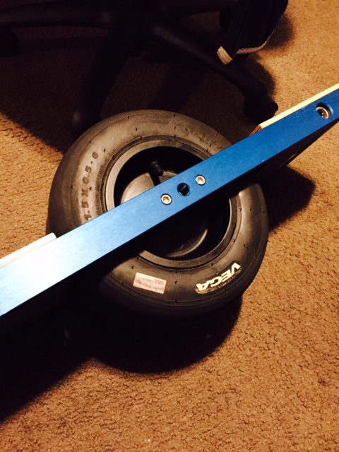

    It may be too late for some people and others may just not care but here are my frame rails after 300 miles of riding. Almost no scratches after letting people ride it and flip it over at least a hundred times. This is why I tape the board with Gorilla duct tape. FullSizeRender 32.jpg

  • utsu 4 September 2015, 11:06 UTC
    Doesnt gorilla tape leave glue residue anywhere it sits on the board out in the heat/sun for so long?
  • MichaelW 4 September 2015, 14:06 UTC
    @utsu Nope. Comes off easily without any residue. In 2.5 months I've replaced it probably 4 times.

    I bought the wrap on a site called wish.com. They have all kinds of stuff, but you can search carbon fiber. It didn't require a heat gun since the board is straight, and I didn't have to take anything apart. It only took a sharp razor and a little patience. I bet it too me 45 min to do the entire board.

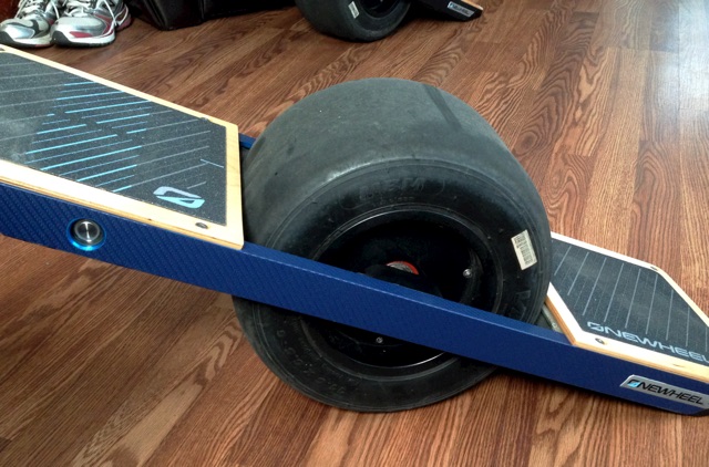

    Here is a blue carbon fiber I put on my second board. This one had some pretty deep sctratches and dings, but it made it look new again. image.jpg
  • J-Glide @ThatGuy 4 September 2015, 22:39 UTC
    @ThatGuy it peals right off when you need to replace it.
    T-CAT 4 September 2015, 23:06 UTC
    Looks great J-Glide. For people inquiring about material, it is often referred to as wrap, or vinyl wrap often used on automobiles and many other objects and surfaces. I have done some car wrapping in the past, as well as vinyl wrapping of other various items. It's relatively easy when you get the hang of it. Purchase a little extra to use as practice pieces on other items similar is shape, so you get the hang of it. Since the wrap is adhesive backed and ususally activated best by heat, you can contour it to the surface easily. Be sure to include excess wrap overhang (that will be trimmed later). Once you peel the back off the vinyl, you can begin adhering it to the surface. You can chose to use heat or no heat. Usually, if the surface is flat and doesn't near contouring over curves, etc., I apply it without heat. Apply it carefully and slowly at the desired angle you want (especially with carbon fiber, so the direction of the carbon is equal on one side as the other). You can use your fingers or a flat squeegee made to glide on the surface of the wrap (or just a credit card) to flatten each part you are adhering to the surface. Make sure there are no bubbles. Sometimes, once I'm done covering all the surfaces I intended, I activate the adhesive with a heat gun on a low setting and not too close to the wrap (or it will burn, tear, overstretch, etc). The heat helps with better adhesion of the wrap to the surface in which it was applied. When the wrap is warm, you can use a finger nail without pressing hard to ensure the wrap is hugging all corners that the wrap meets, so when it is trimmed, there won't be any gaps that you intended to be covered. Once the wrap has fully cooled (if you used heat), then the wrap can be carefully trimmed with a hobby knife. Be careful and take your time. Once it's all trimmed, I take the heat gun to the any area that was trimmed to seal it to the surface, so the wrap doesn't lift.
    I'm no vinyl wrap expert, but have done enough to feel comfortable with it. There are some great videos of professional vinyl wrap installers that are great to watch and learn.
  • utsu 4 September 2015, 23:10 UTC
    I suppose you never see "the other side" of the rails, so you don't have to be quite so neat on the inner wall of the wrap.
