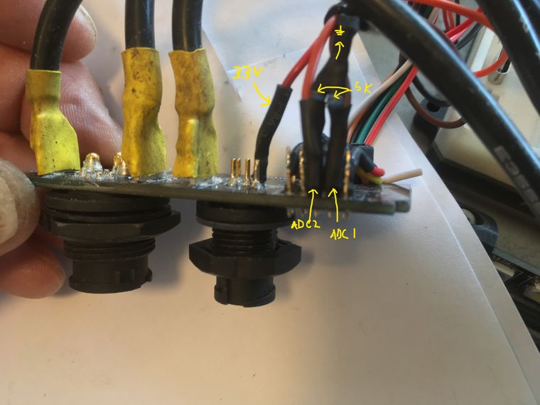

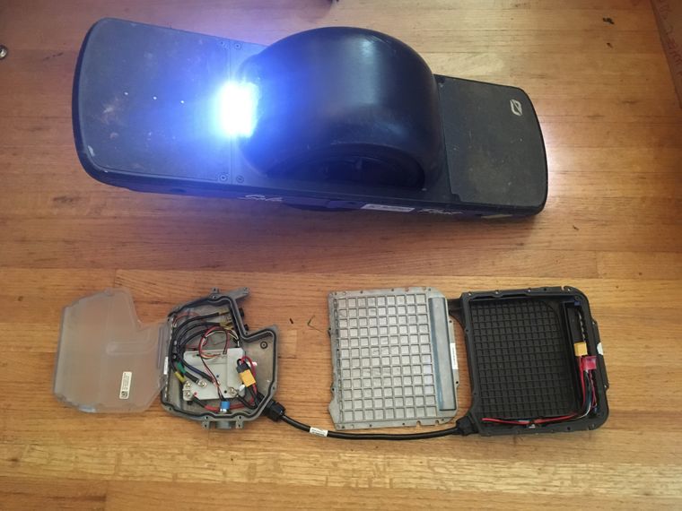

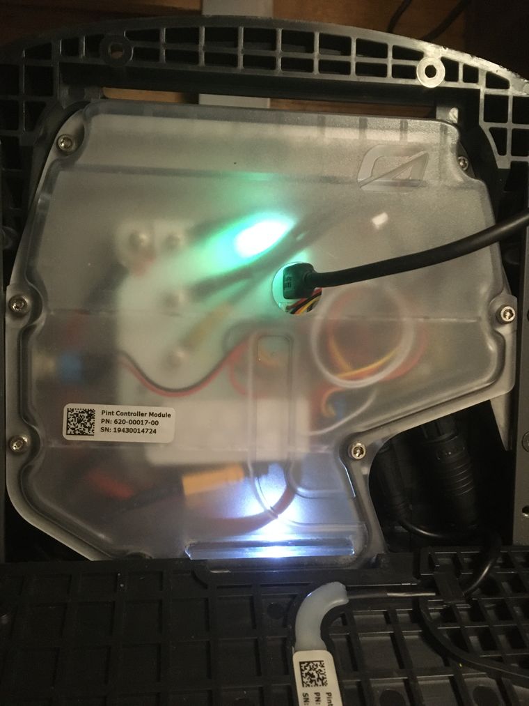

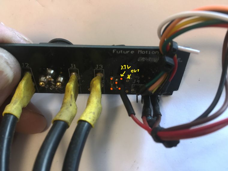

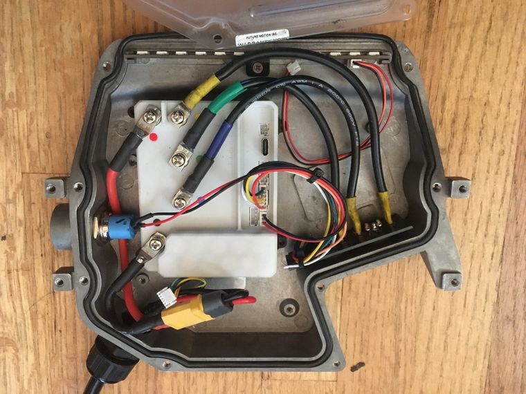

    I bought a Pint battery box and controller housing combination with a shorted out controller. I used part of the controller circuit board and wired up a Raiden 7 vesc to it. Installed the reworked module in my spare Pint, programed the vesc and made a rideable board. The battery is stock Pint. I was able to to reach 23 kmh with no pushback. I didn't want to push it further, trust issues with new builds. Still more fine tuning to do.
