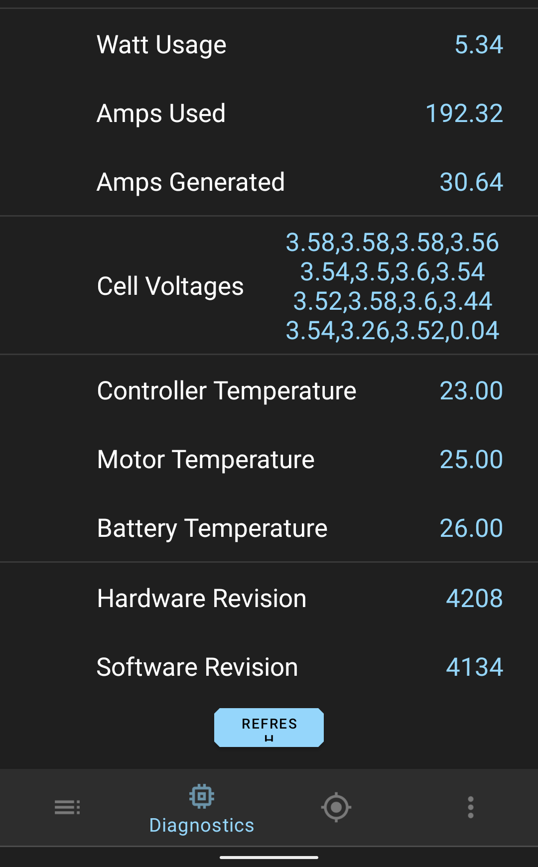

    How long do you think this pack has before it's done....
    This was after an overnight balance charge and a shortish 7km ride.

    @stinkyface That second to last cell looks very out of place.
    What does it look like when it's "finished" charging right after the green light comes on? You'll want to wait till it goes green then take it off charge and see what the cells read, this way you can see where each got to by the time one hit the full charge mark.

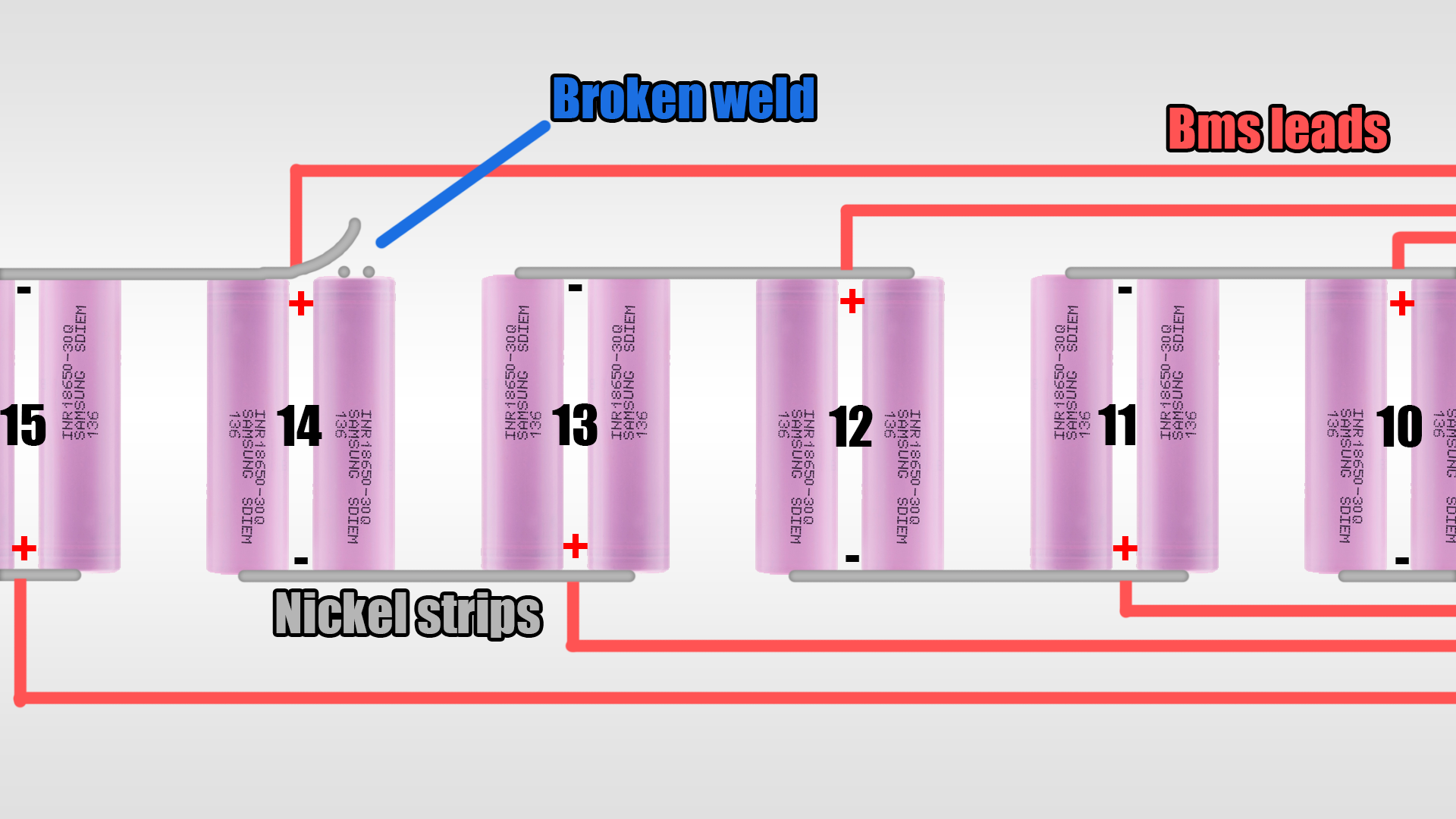

    @stinkyface Let us know if the issue resolves itself after a longer charge, if it's still not working I think you may have a broken weld. The situation doesn't sound to me like a dead cell, I've never seen them go bad like that considering the circumstances.
    A sudden sharp vibration can break the welds if they aren't done well. This would make sense as to why you've seen nearly a complete halving of your range suddenly.
    To add to confusion the issue may spontaneously come and go as the weld makes contact randomly from further vibrations. This isn't ideal as it can make contact when there is a voltage imbalance that would cause them to charge/discharge rapidly where the BMS cannot protect them.
    Below is an illustration of what the issue might be as described above. Hopefully this helps better show what I mean.
    When this happens you halve the capacity of the cell pair and in turn the rest of the pack because the BMS steps in.
    Doing surgery on the Onewheel battery isn't easy though, it's wrapped in tape, covered in balance wires and the welds hold the pack together pretty securely. I wouldn't recommend the type of repair to many since battery welding requires kit to do it properly which puts it out of the realm of possibility for most.
    You may have luck with an eBike battery repair places, they're more than familiar with weird pack layouts and would probably be easy for them to re-weld whichever cell came loose. They may even be able to quote you for a rebuild if you feel your cells are on their way out anyway.

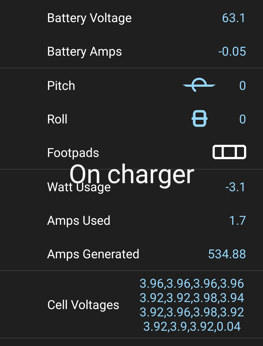

    Rode in again today and got a couple of screenshots post overnight charge. This one is while still on charge. Still holding 63v overall:

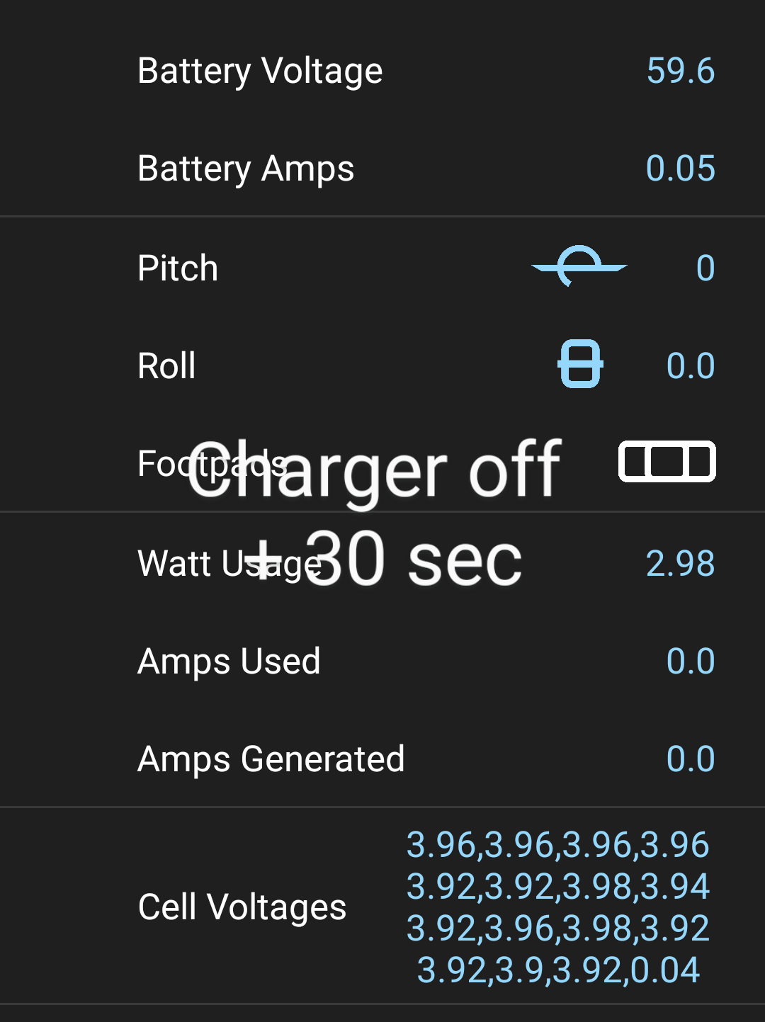

    Then 30 seconds after turning off the charger, cells stable but overall voltage down

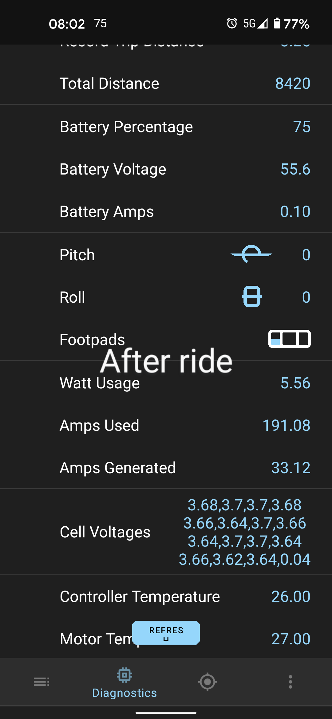

    Then after a ride...cells look like they are singing a similar song again.
  • stinkyface @stinkyface 20 July 2021, 00:02 UTC
    Gives a good indication of how the charger works. I was actually watching the cells voltages when the charger flicked to green. They all dropped straight away.
    Looks like the balance function was bringing the other cells down to match the low cell. I'd always assumed it would pump power into the low one to bring it up.

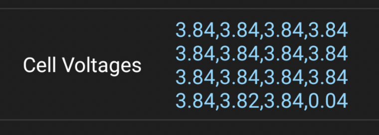

    Just to close this out. Ride home tonight after more balancing at the office today.
    These puppies are licking the same bowl! πŸ˜ŽπŸΆπŸ‘Œ
