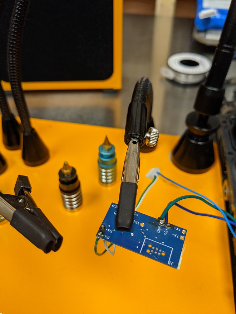

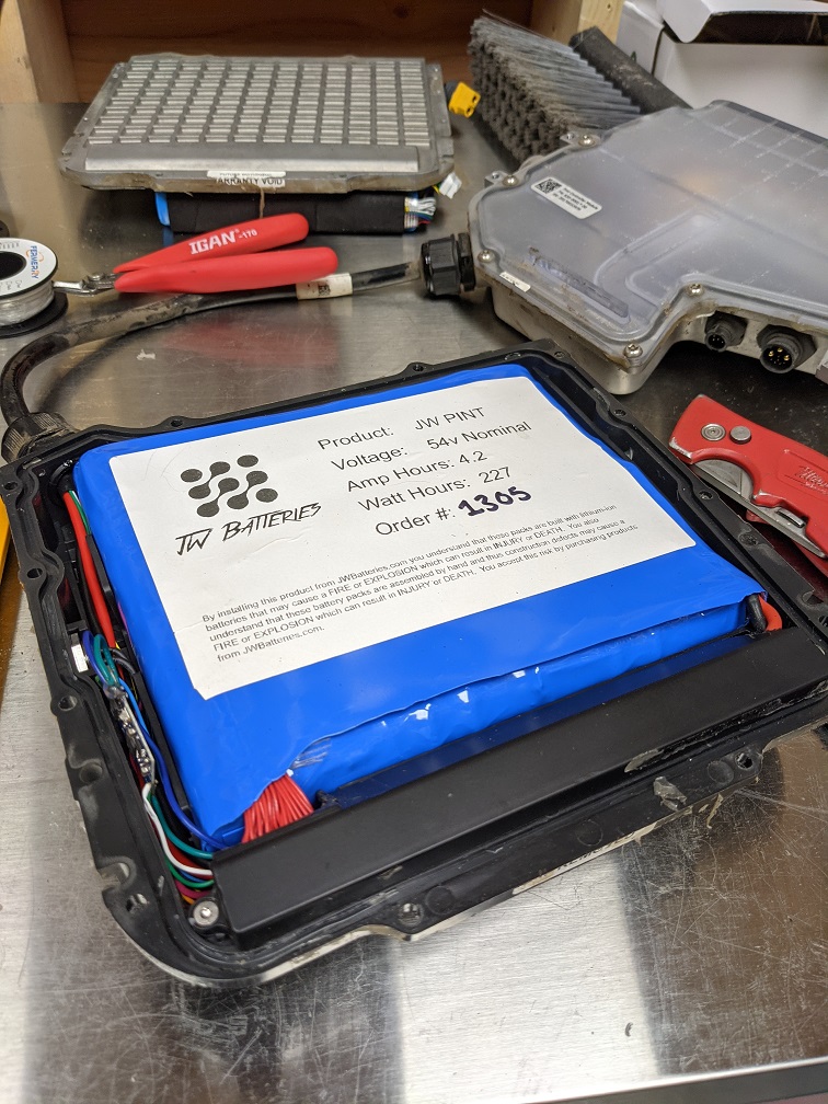

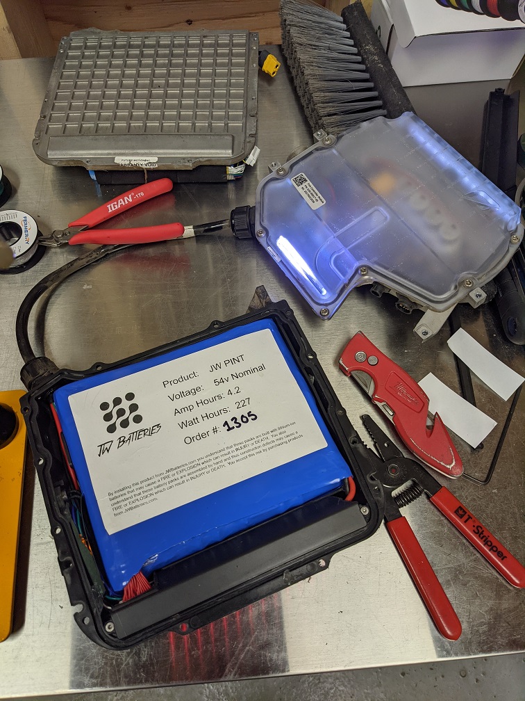

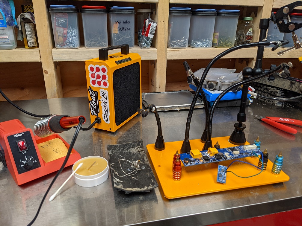

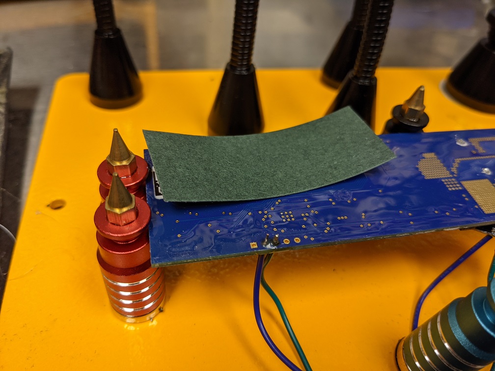

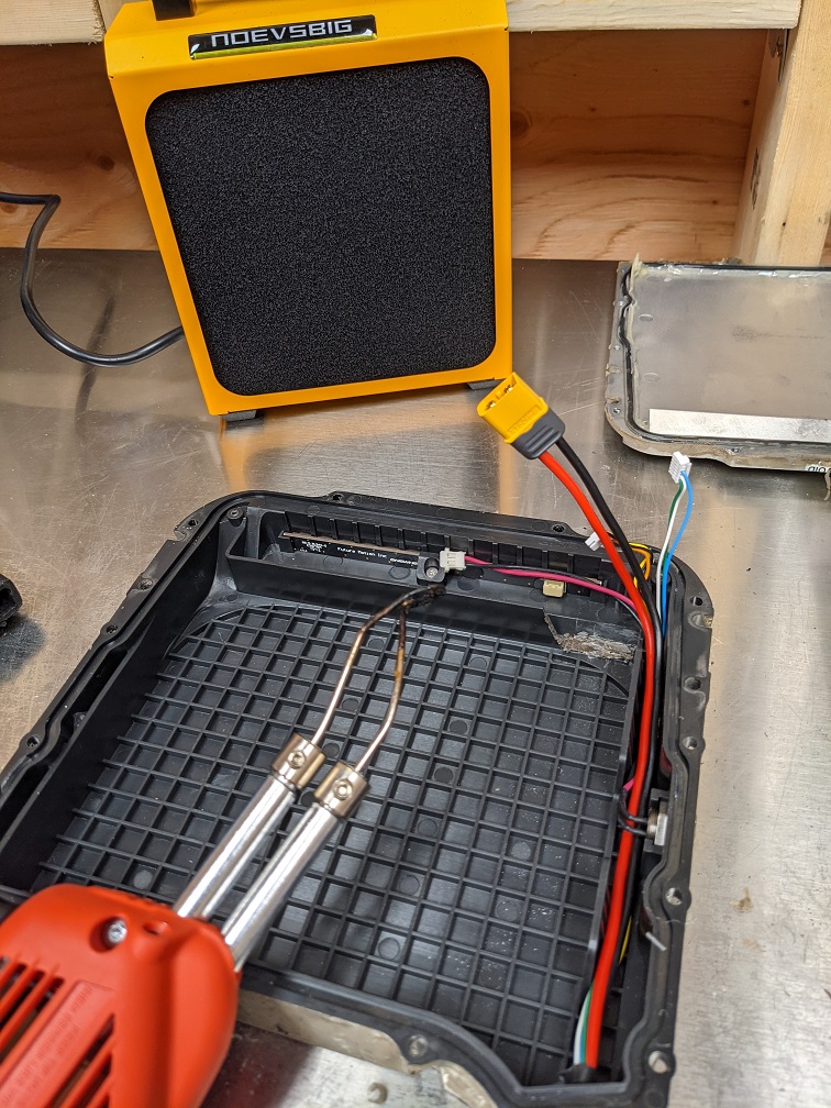

    in other news, last night i installed the jw pint battery too. the instructions for that were non existent, and so i had to wing a couple things. i ended up putting the ffm chip on the left side among the cables, since the wires going into to it didn't go from the right as in the xr. used my big soldering gun to cut off the housing pieces that were in the way. and i had the right soldering iron and flux now for the little stuff, so that turned out way better than last time. and it works too which is nice.
