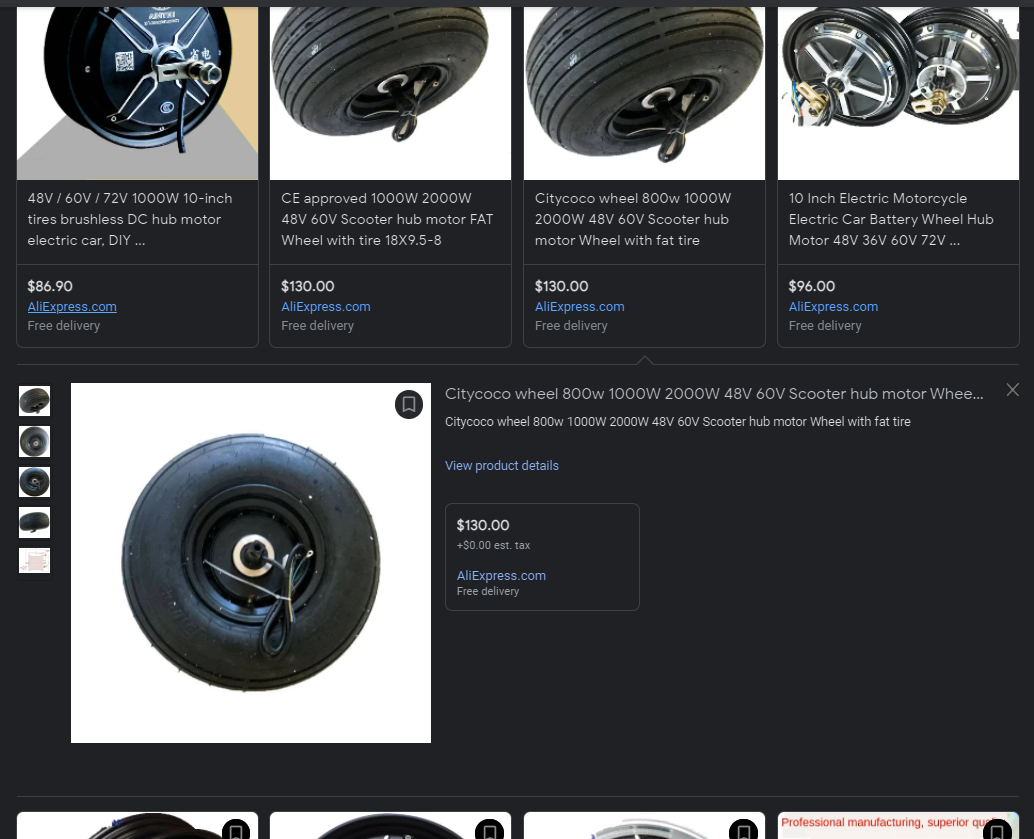

    @Lia well if that aint definitive! so much for that myth. so has anyone replaced their motors lately?
    Lia 1 Reply   Reply Quote 1
    Lia @NotSure 8 November 2021, 10:55 UTC
    @NotSure The 750w motor FM use might still be capable of more. Motors are a bit of dark magic that I have yet to understand. I need some electrical wizard to sit me down and explain it >.>
    The wattage rating on the motors seems to be some sort of estimated power rating that I have yet to find consensus on how they measure this. For instance my old eBike's 250w motor to this day manages to let me put over 500w through it if I just change the controller and battery to allow that to be delivered.
    So that being said I assume that 750w motor on the Onewheels is capable of way more that 750w if it is given the ability to draw it. Leaving us looking at the ESC that manages power delivery.
    NotSure 2 Replies   Reply Quote 2
