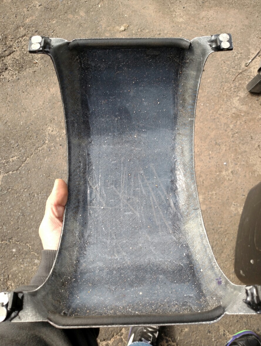

    Anyone who has a fender knows they are a bit noisy from grit and pebbles .. I coated the underside with a thin layer of silicone glue from home depot.. I made the layer mostly 1/8 inch thick.. Been testing for a few days and I'm extremely happy.. It's like the fender is not even there..

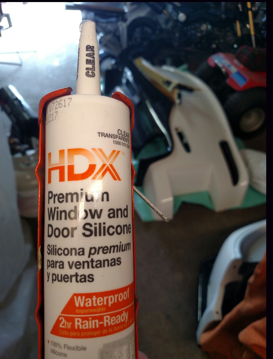

    can you post a picture of the product you used? is it a spray or a tube?
    njcustom @cr4p 20 March 2016, 20:06 UTC
    @cr4p here ya go

    @njcustom I was thinking, Cool, I already have a tube of that stuff! But I checked it and the entire thing is dried up. Oh well, I'm always headed to HD for something anyway.

    Doesn't seep through the carbon fiber weave?? I was thinking about undercoating was nervous though
    njcustom @dirtyjersey 21 March 2016, 01:09 UTC
    @dirtyjersey you're good to go.. I suggest black but i used clear..
