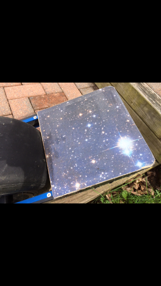

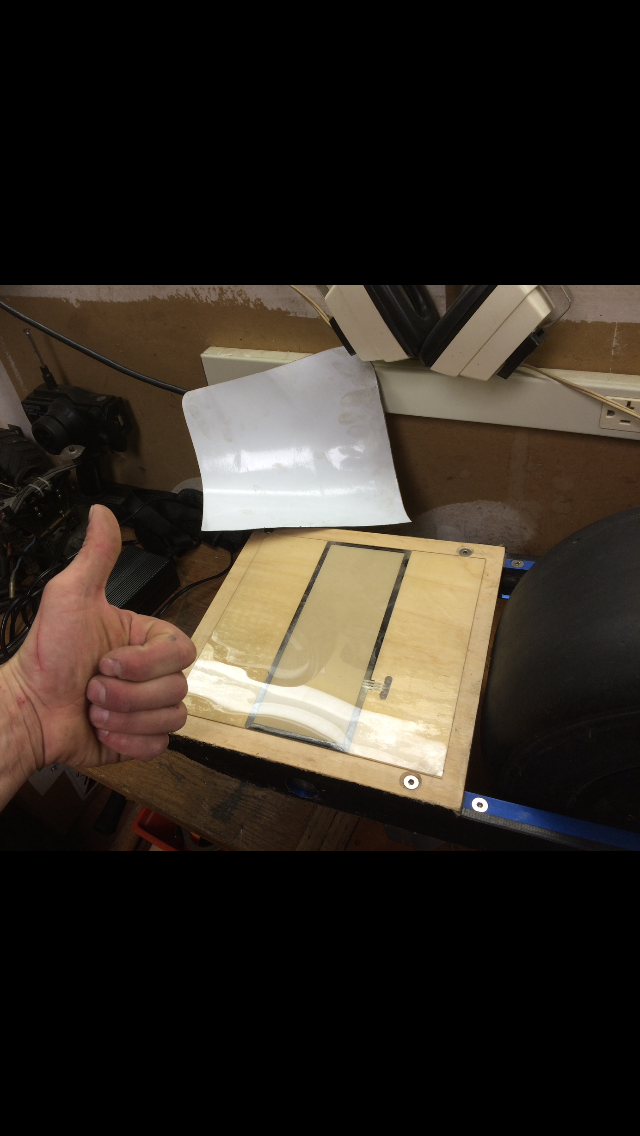

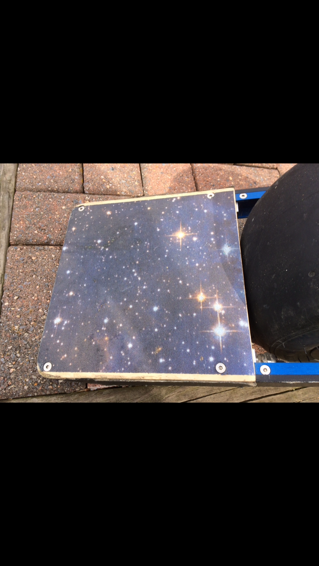

    kbman 22 April 2016, 19:49 UTC
    kbman 22 April 2016, 19:52 UTC
    @skidepowpow![2_1461354666972_image.png](Uploading 100%) ![1_1461354666972_image.png](Uploading 100%) ![0_1461354666971_image.png](Uploading 100%) 0_1461354612313_image.png
    kbman 22 April 2016, 19:55 UTC
    kbman 22 April 2016, 19:58 UTC
    thegreck @kbman 22 April 2016, 20:00 UTC
    @kbman Looks awesome! Use the crop tool on those screenshots though. Looks like a letterboxed DVD from the 90s.

    spring 24 May 2016, 03:30 UTC
    hey kbman, thanks for tip and photos. Have a couple of questions.
    I notice the rectangular sensor of course but also notice a glossy material that covers the majority of the pad. Is this to weather protect the sensors? When you heated up the old grip, did it peel cleanly off that protective material without damaging it? It appears to be adhesive-free in your picture so was wondering if you cleaned off the old grip tape adhesive before applying the new grip? Also, I'm liking the Vicious tape mentioned by thegreck2, but am worried that a 'thicker' or more durable grip tape could cause a problem with the sensitivity of the sensors. We all know the need to have perfectly working sensors!! Look forward to your response.
