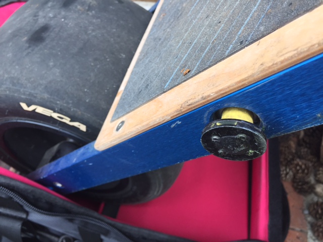

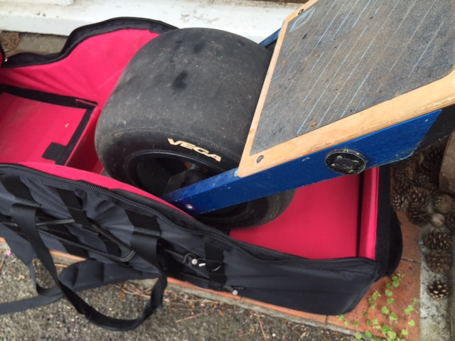

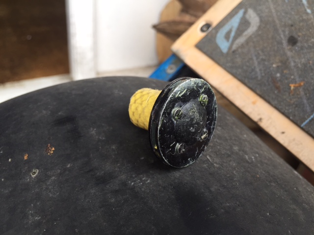

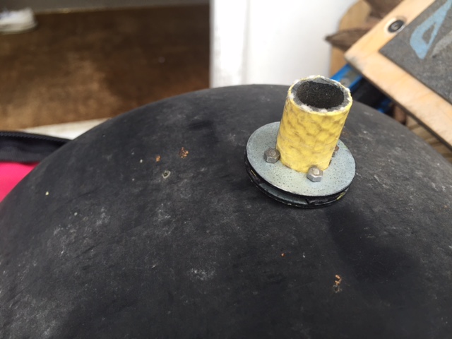

    If you fancy getting handy then a plug can be made out of a piece of hose, spliced and sandwiched between 2 washers, 4 small bolts and a stopper. Works great.

    Jimmers Ill have to give that a go. Seems like an easy and cheap way to get those done up

    @juts That seems cheap and easy? You can buy a handful of dummy plugs from that link they gave you and have them shipped to you for less than $5.

    @thegreck im in canda :( where as all that stuff Jimmers said I already have.

    @juts This I Understand, If you already have it all around the house just make it, it cost 0.
