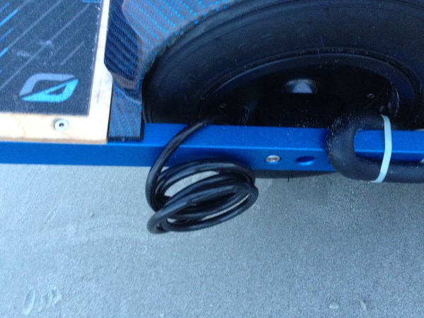

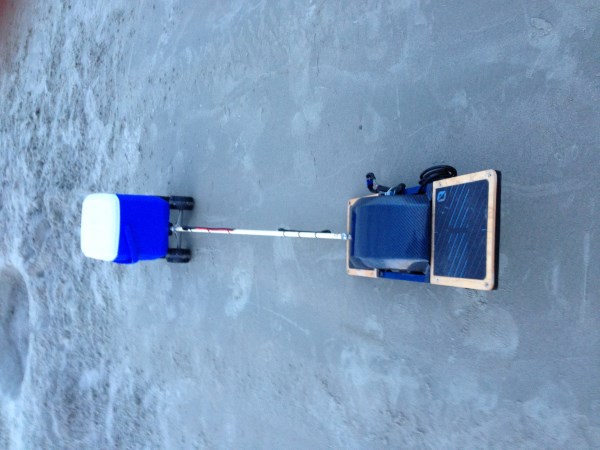

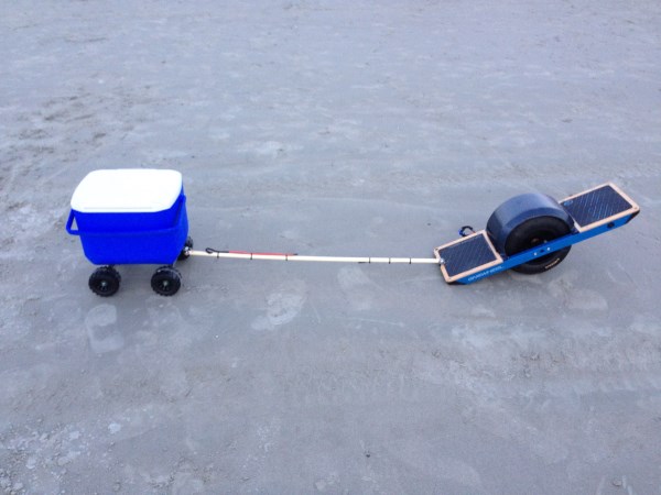

    If you have not realized it yet, I am a bit of an attention whore. I love being the first person to have something cool, and love modifying or inventing new things. As you may recall, I am very close to finalizing my external battery project, and you will see some of that in my photos to follow. However, I got side tracked with my newest project, which has been a resounding success! Even the people who have seen me on the beach with my OneWheel before were absolutely mesmerized by my latest project, which I just tested today. I had several reasons for developing this, most importantly to have cold beer available while riding on the beach, but also for a place to carry sunscreen, cell phone (to play tunes through my bluetooth speaker which I mount on the fender-not shown in these photos) and ultimately to be the home of my back-up battery for the OneWheel.

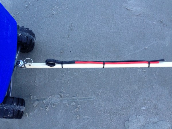

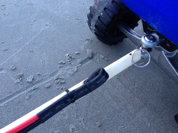

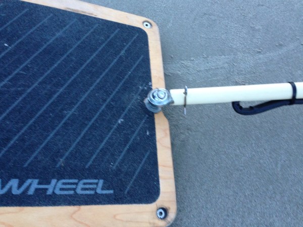

    As any of you know, taking anything along with you while OneWheeling can be challenging. I introduce the OneWheel Trailer/cooler. I obtained a small-medium Coleman cooler, and mounted a set of the widest skateboard trucks I could find, and added a set of the largest 4 urathane off road skateboard wheels and tires I could find. I devised a tow bar, which after several failures works fantastic, all while serving as a conduit for the battery cables I intend to use for my back up/replacement battery project, which is near completion. As you review my photos, note that I used high quality "rod ends" to provide low-friction steering, and a somewhat flexible CPVC pipe which connects the OneWheel to the cooler/trailer, while allowing the battery cables to pass inside.

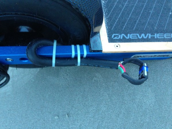

    You will see a coiled cable lock mounted on the side, which I have mentioned before. However, the real accomplishment, in my opinion, is that I opened up the battery box, and was able to add some wire cables which externally can be connected/disconnected, to ultimately allow the easy installation of an external battery. That is a whole other story, which I will share once complete, but I am trying to explain what you are seeing. (sorry, not having luck posting photos, will try again)

    Finally I got it! Pics uploaded. I have been test riding and as somewhat of a perfectionist, I still have some kinks to work out. I took it on the golf course yesterday, and got a really great response from everyone! It tends to like to trail to the left or right, and I need to make the front wheels and truck work on some type of pivot point, so the trailer trails directly behind. It is no issue, except in tight quarters. I think you can see my thinking on the external battery. The hard part is done, which was rewiring the existing battery box and tapping the main battery input to make it externally switchable or plugable). There was virtually no extra room in the battery box, so I had to really innovate to get it done, but I got it all back together, and resealed it so it is again waterproof.

    I was riding this AM with my new trailer, and lost track of distance and id died about a mile from home. That is a LONG damn way to carry this 25 pound toy, AND my silly cooler trailer. That is why I take the cable lock with me: I can lock it up safely somewhere, jog home and grab my car to retrieve. However, today it occurred to me that my Onewheel fits perfectly in the cooler, upside down with fender in the cooler. I pulled it home like a wagon, with no effort whatsoever. Kind of a nice side use, though the primary one will always be to lug along some cold ones for hot beach rides!
