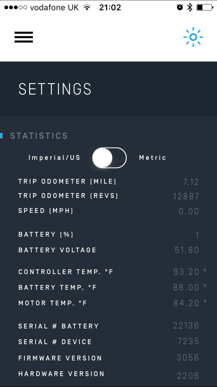

    thehoff @ahxe45 16 August 2016, 21:11 UTC
    @ahxe45 0_1471381772670_image.png 0_1471381826525_image.png check out tonight's mileage!!
    Going to hang onto the board and see how it goes! 7.1 miles
  • thehoff
    thehoff @ahxe45 16 August 2016, 21:13 UTC
    @ahxe45 it was just a gently ride around the streets staying off the grass
    ahxe45 17 August 2016, 02:45 UTC
    That is usually the typical range I get for just riding around the streets.
    thehoff 1 Reply   Reply Quote 1
