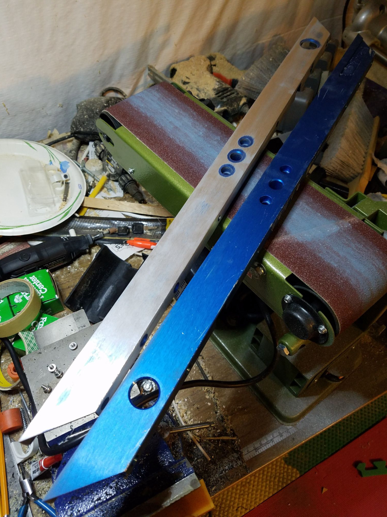

    3. Use the belt sander to abrasively remove the blue on the flat surfaces: top, side, bottom. When I did it I found that the sides are surprisingly not perfectly flat (this may be from stress of regular use). The (optional) wire brush could be handy here for some touch-up like this or for the ends or it could be taken care of in the next step. I chose to leave the bottom surface that had the serial number as is.

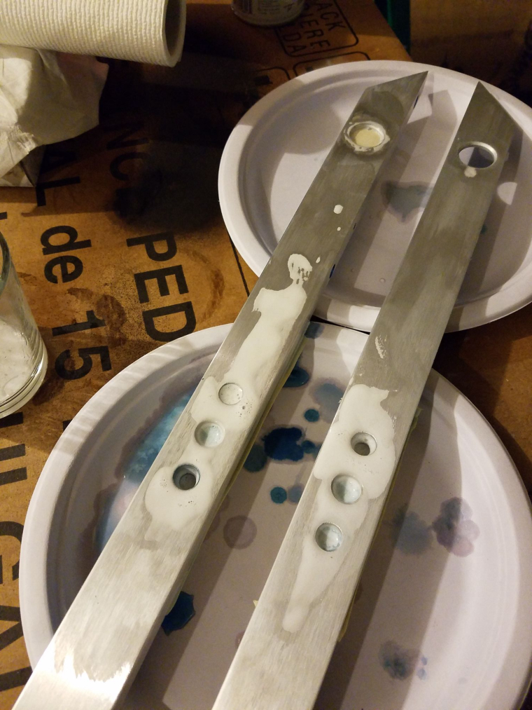

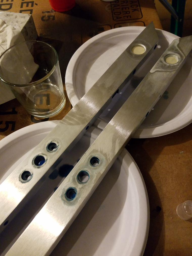

    5. Now we play with chemicals. Use the oven cleaner to do the recessed parts (power switch, charge port, motor attachment, etc). This can also be used for the ends and any stubborn blue that didn't come off with abrasion. Also be sure to do this in a well ventilated area and do NOT let the Lye touch your skin, it will burn (wash off immediately). Using the oven cleaner means babysitting the parts. It is not just apply and come back in 20 minutes. To get the cleaner in a workable liquid I sprayed it into a short glass and poured it over or used the Q-tips to apply it. Keep the areas to clean coated in cleaner. Every few minutes rub off whatever will come off using a Q-tip. I used masking tape to cover the bottom of each hole and then filled the hole with cleaner. Soak, scrub, soak, wipe, repeat. This is the most time consuming part.
    6. Wash off both bars again. The cleaner may leave bleached splotches that may not wash off. If necessary, grind more and re-wash.

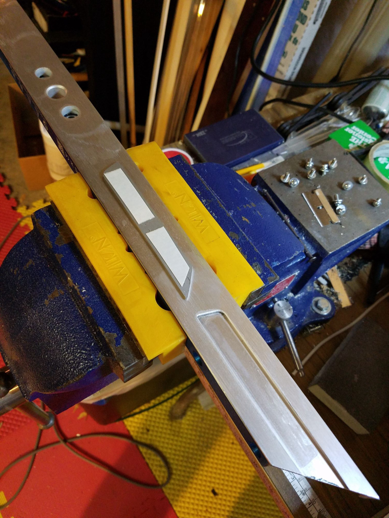

    7. Clean off the OneWheel badge and use the mounting tape to reattach.

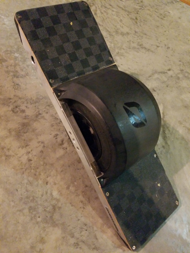

    8. Reassemble the OneWheel and enjoy.

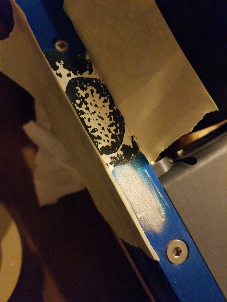

    When I was experimenting I found I could not simply cover an area with cleaner and leave it alone. Most of the blue did come off but it also seemed to pile up in spots. I think it is important to clear this away periodically. Scrubbing the surface is also effective.

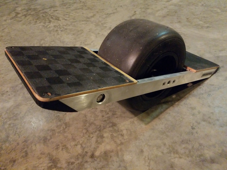

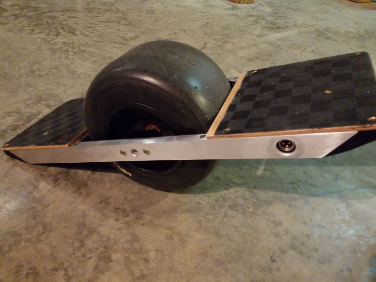

  • Zluz
    Zluz 2 January 2017, 15:53 UTC
    Sanding in progress
    Oven cleaner treatment
    Mounting badge
    Ready to ride
  • Zluz
    Zluz 2 January 2017, 16:06 UTC
    Earlier experimenting
    Earlier treatment shot
    With detachable fender

    Looks good! Thanks for posting a tutorial, I never removed the blue from the holes, now I know how lol
    Zluz 1 Reply   Reply Quote 1
