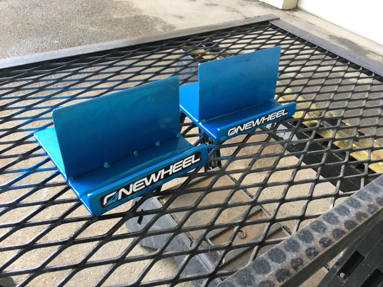

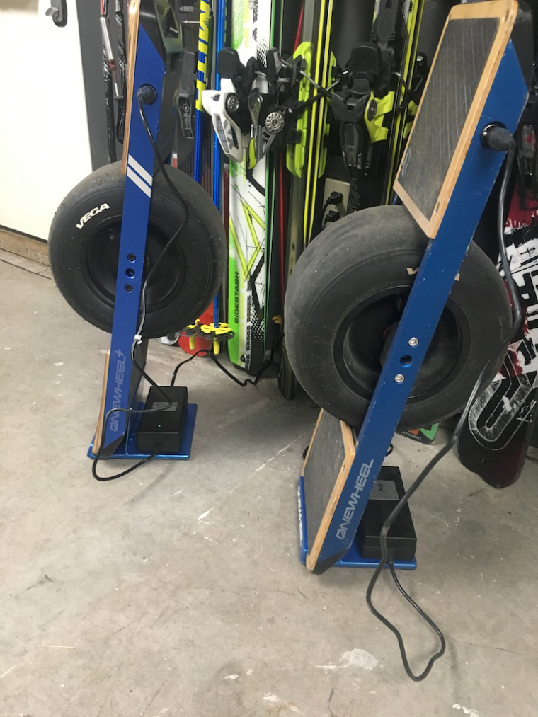

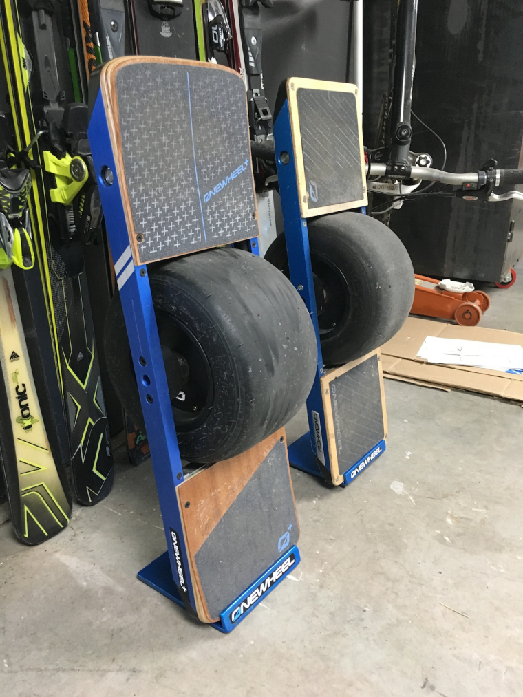

    This is my design for a metal stand. Works well and smaller footprint than the WaveStand. $5 worth of scrap metal, a rattle can spray job and a cutout from my board's box. And charges without issue in vertical orientation.
    Nice for keeping the tire off the wall.
    No W 2 Replies   Reply Quote 17

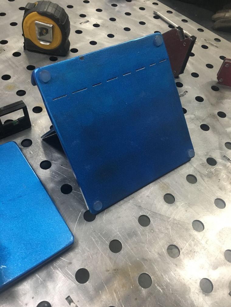

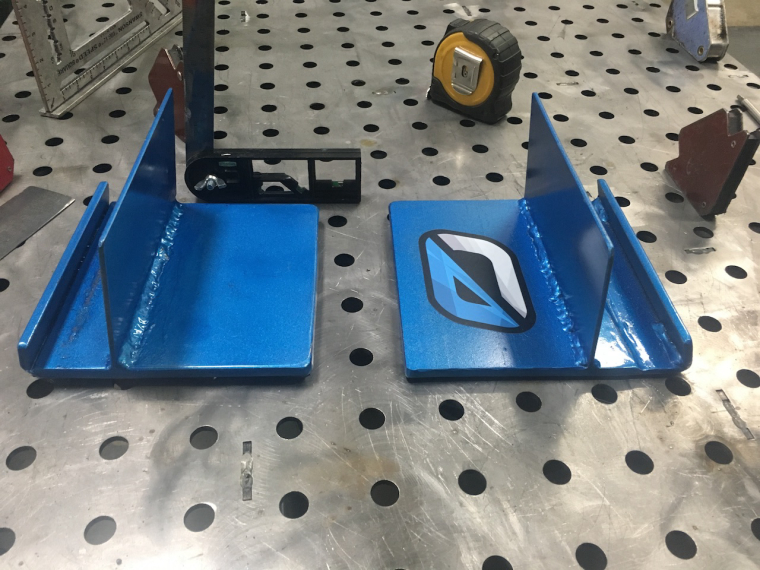

    dougzilla 24 May 2017, 05:00 UTC
    Hey guys. It’s nice to hear so many positive replies.
    These little digressions of mine take me way longer than what a true fabricator could crank out and so making these for sale would just mean less time for me to ride my 0Ws. Right?
    So, with that said, consider this design open sourced to any hobbyist or motivated Maker that wants to build and/or sell them.
    Here is the quick rundown. All mild steel.
    Base is 3/8 thick x7x7 inches for the V1 base and 7.5x7.5 for the 0W+
    front lip is 3/8x1 bar welded to the front at an 80º angle
    upright is 1/8x4 inch flat strip welded to base at about 83º angle, 2 inches from the front for the V1 and 2.5 inches for the Plus.
    If you are like me, then a fair bit of grinding with the 60 grit flap disc is now in order. A bicycle frame welder could make this beautiful without the need for touchup.
    Little adhesive lamp bumps for the bottom make it stay put.
    This can of paint does one stand. Finish with a sticker or cutout and clear lacquer gloss.
    http://a.co/eRj6o0p
    Have at it!

    spaz 6 June 2017, 22:02 UTC
    I purchased one before I got the onewheel + and it fits it perfectly. It stands upright and hasn't fallen off the base. I was a little concerned too at first but I sent an email asking if it would still fit the + edition which they reassured me it would.
