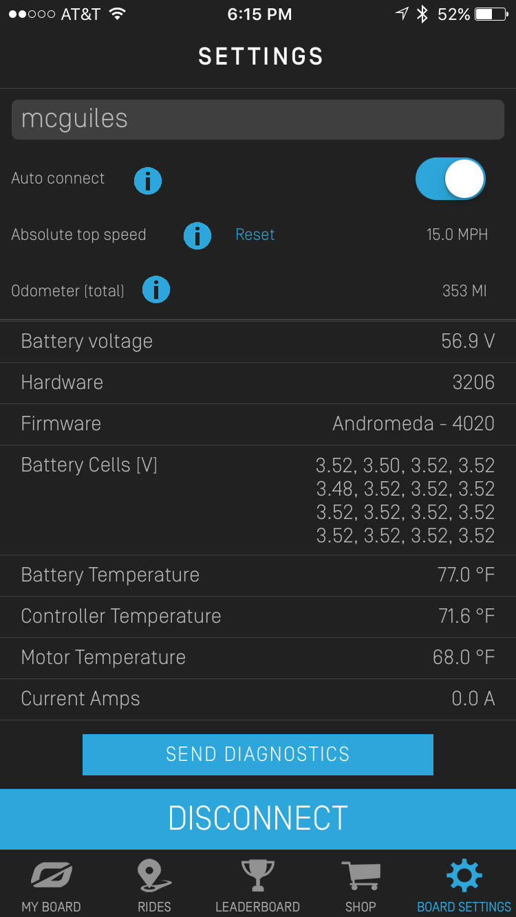

    mcguiles @bmtka 8 September 2017, 00:17 UTC
    @bmtka i'll have to check. this is what it looks like at 100%

    @mcguiles At 100% they should all be reading the same. Have you done a 24-48 hr charge?

    you need to take a reading after you have ridden the board for a few miles. The picture you took is normal but is not a good indication of a batteries health. You need to discharge it a little bit to get a good idea if one cell is bad or not.

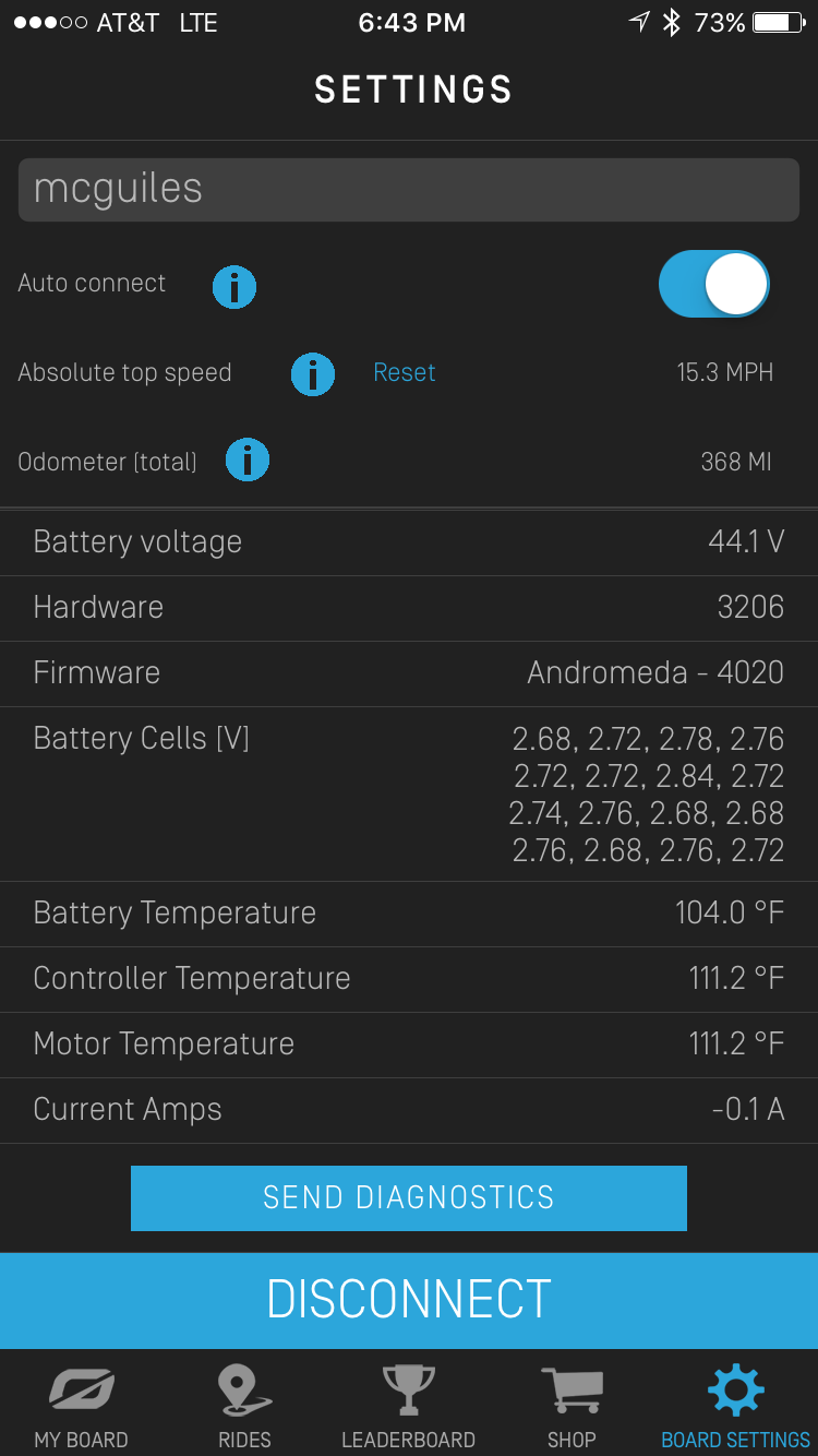

    mcguiles @bmtka 12 September 2017, 04:27 UTC
    @bmtka here is a screenshot from when i was getting the crazy kickback again

    You are getting kickback because that is a fully dead battery, regardless of what the % says. When you get kickback, shut it off then on and ride it again until it refuses to balance. If the battery drops to 1%, do the 24hr charge. If it still says something like 7%, let it rest 10 min or so and then try to ride it again. The long recharge won't work to recalibrate unless it reads 1% when you start. If you are unsure of the battery meter, check the cell voltages. It will stay at 3.24-3.2 for a long time, but once it says 3.1 it will drop to empty quickly, maybe in a half mile.
