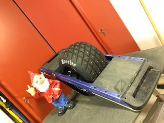

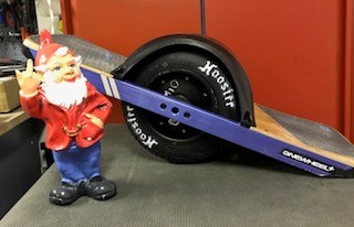

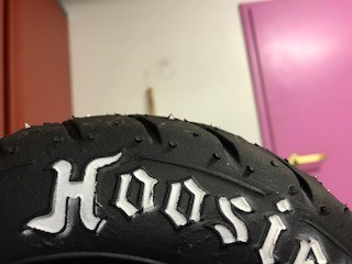

kristian 15 November 2017, 09:16 UTCK
Hi
Here is some pictures this hoosier with "snow" tires.
All ho planing to do same!!
I buy hoosier 11.0x5.5-6 and add there 2.2mm spikes as you can see pictures.
First ride 15psi felt fine, but after that I try higher pressure because I read that somebody ride over 30psi this same tire.
30psi makes tire so much bigger that spikes start grind ow+ frame !!!
20psi is max tire pressure what you can use with 2.2mm spikes.
But after all 20psi feels perefct fo me. -

kristian 16 November 2017, 08:54 UTCK
Hi
You can buy studs example www.gripstuds.com, I assembly product #1000 around 47pcs
Remeber that if you palning to put spikes under your hoosier, tire size must be 5,5 not 6,5 wich is best size with out spikes! -
