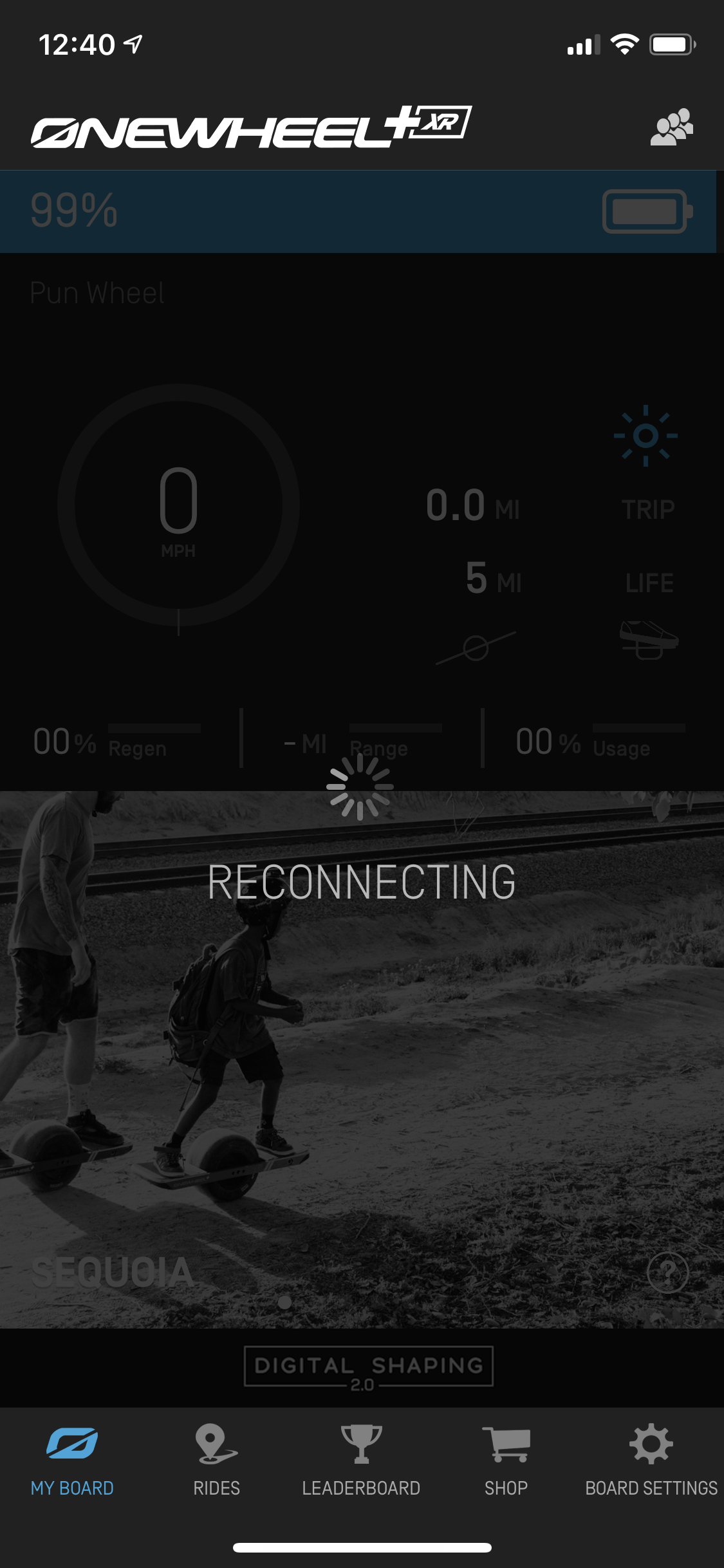

    Sucks. Just got my XR and I'm having trouble keeping a solid connection to the app. When I first start off, it's very difficult to connect. As I'm riding, I'll take out my phone to see what the numbers say and it has the "reconnecting..." screen of death. What this means is as I'm riding, I don't maintain a connection at all and thus I can't get any alerts (footpad sensor, over regen, %50 battery, etc...). It's only when I take out my phone to look at the app does it connect. As soon as I put my phone in my pocket (with the screen locked), I've lost connection!
    To rule out it's my phone, I test it with my OW+ and it works fine. The + keeps a constant connection and gives me alerts along the way (w/o me having to proactively look at the app).
    @danner did you get this bluetooth issue resolved? Is anyone else having dropping connections btwn the board and the app?
    The board rides fine, but I just can't ride without the app. And having to reconnect every time I pull out my phone is really annoying and impractical.
    Even while holding the phone in my hand with the app open, it still loses connection and constantly shows "reconnecting..."
    argghhhh

    I, too am experiencing connection drops while riding.
    If I just turn my board on and let it sit there—it immediately connects to my app and stays connected without a single issue. It will stay connected until I walk about 10-15 feet away.
    It does drop though when I turn my back to the board and I’m right next to the board (putting my body between the board and my phone)
    It drops constantly while riding. It is disconnected more than it is connected. I think my foot must be over the antenna in the board.

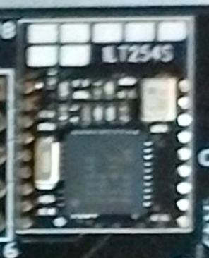

    Can someone confirm where the Bluetooth antenna is in the XR? Like specific location, not general location. Pictures would be even better.
    I think the Bluetooth chip in the board is super-weak. For comparison—I can walk across my house (100+ feet), with walls, appliances, etc between my phone and my Apple Watch Series 3 or my AirPods and I keep my Bluetooth connection perfectly fine with my phone.
    I wonder—does goofy vs regular matter? Those who are having problems; what is your riding style? I’m goofy.
    Also, people having problems; do you have float plates? I do. Finally, do you have a handle on your board? If so, which side? (when looking at your board from the back)
    Our feet and/or aftermarket parts may be insulating the already weak/underpowered antenna.
    Hopefully it is a power issue—that is something a firmware update may be able to fix (allow more power to be fed to the Bluetooth on the board to increase its reliability/range). If it’s a limitation of the hardware—these would all need to be sent in to have the chip/antenna replaced.

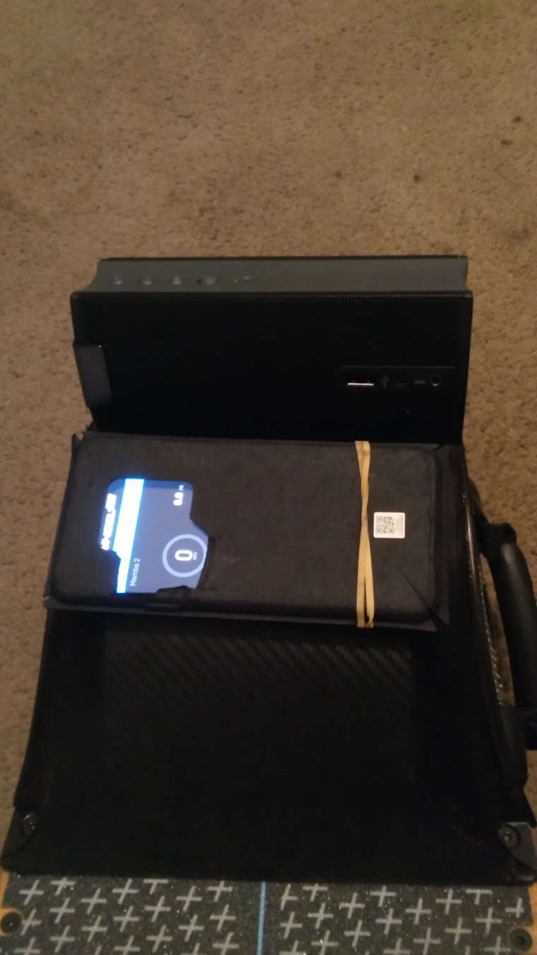

    eckit @Rado 22 September 2018, 02:03 UTC
    @Rado I can confirm that sitting the phone right on the footpad works. I also put the phone in the neck of my boot while riding and it kept connection the entire time. Feel free to share that with them too. That leads me to believe it isn’t that the board is dropping the connection—it’s a range issue. The signal is too weak.
    I’ve also ridden with the phone in my hand about 5 inches lower than my pocket and it keeps the connection. I don’t recommend this because the board gets unstable—at least for a newb such as myself.
    I am 6’2”, if I was 5’5” or wore my pants around my knees—I’d wager that it would keep the connection, too. :)
    Fat, Flat, & Slick

    gsparx 25 November 2018, 19:39 UTC
    I have reasonably good news for all of you fine people here.
    I finally got around to testing my onewheel that came back from FM last week (work has been insane). I'm happy to report it's FIXED!!!!! Mostly.
    The issue I was having was that it would lose connection to my phone unless I had my phone down by my shin. It completely disconnected once in my pocket. It connected fine while plugged in, but as soon as it was moving, the connection was awful.
    Now that it's been returned, the behavior is this:
    • 100% strong connection while holding my phone in my hand (iPhone Xs 12.1) I was able to move it up to face height and maintain a strong connection
    • Slightly worse connection while in my front pocket. My apple watch never showed a disconnect, but the current speed would freeze and unfreeze occasionally.
    This feels like an acceptable level of functionality for me at this point, and I'm pretty happy that my phone maintains its connection now.

    I'm having this same issue.
    This was taking with me just standing on the board with the phone in my hand (back foot down, no major pressure on front plate)
    While riding, almost no connection at all - I would say it's connected about 5% of the time.
    I've sent a request into the onewheel support about a week ago, but no dice with responses yet:(

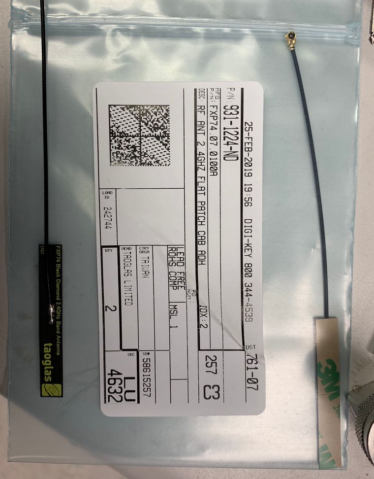

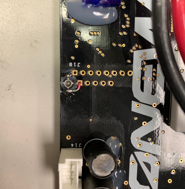

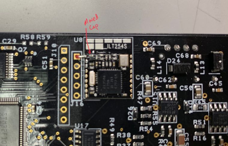

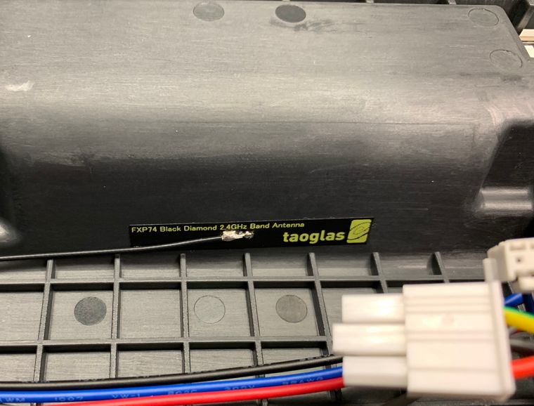

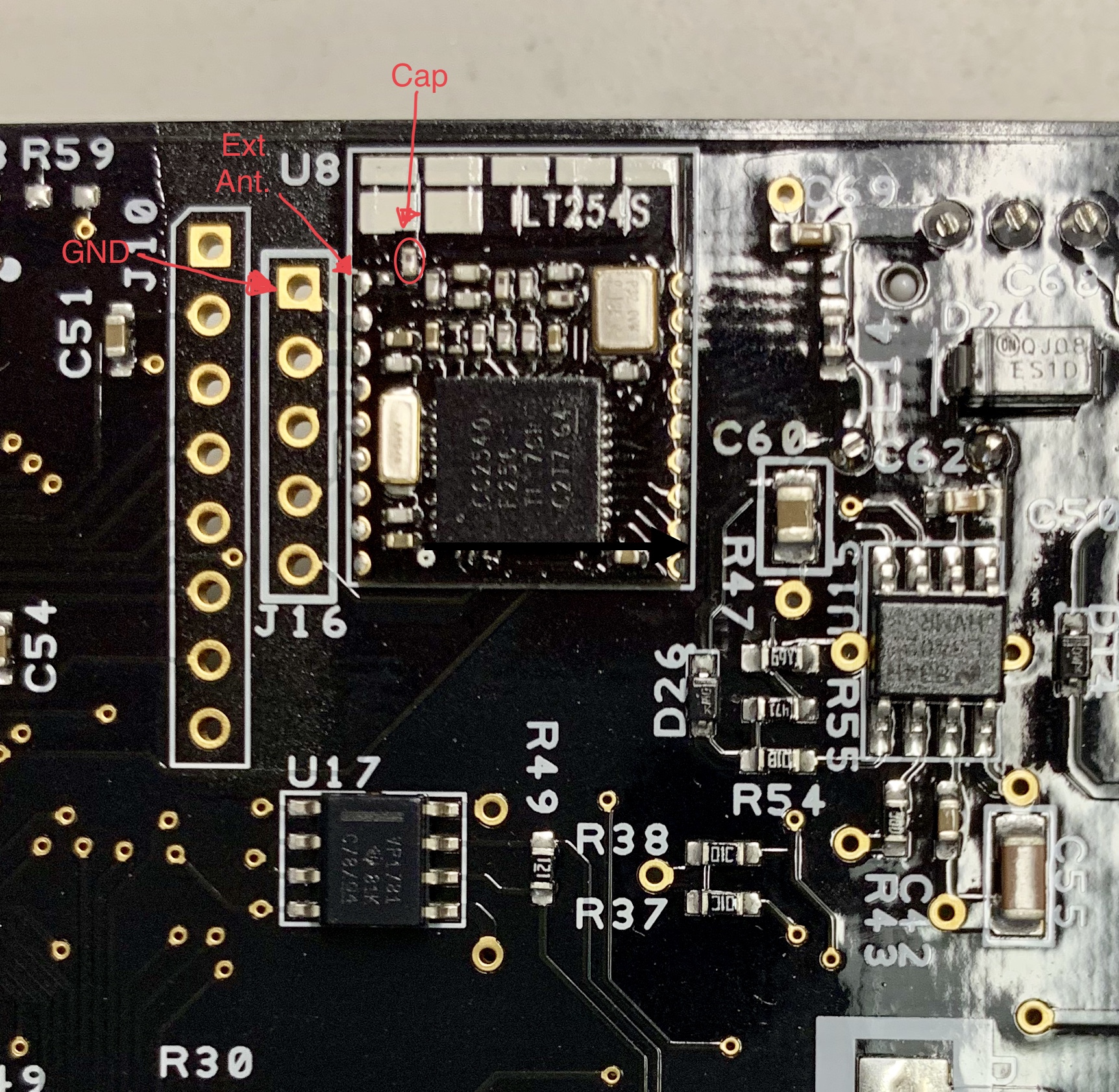

    CaptLucky 13 December 2018, 21:15 UTC
    Hey all been dealing with the failing Bluetooth signal sent Onewheel a request for help and they have responded quickly to the request. I have receive a shipping label and have sent them the following images to prove it’s a Bluetooth issue with the board. I will update this with further info once the board is sent in. The images are of signal strength with my IPad on one side of the kitchen and the Onewheel on the other when the phone is on the Onewheel and when the phone is on the IPad. As you can see the signal strength (phone on IPad) is full five bars with the Onewheel strength at Zero bars. The signal strength on the Onewheel (phone on Onewheel) is two bars and the signal strength from the iPad on the other side of the room is the same at two bars. (UPDATE) Sent in my Onewheel to FM on 12/1 (I couldn’t send it in before had company coming and wanted to ride) with their prepaid shipping label. They had the board for maybe a week and it is on its way back to me should receive it tomorrow. The techs notes said he found the same weak Bluetooth signal and changed out the whole circuit board and it tested fine after will update again once I have the board back. So far I am happy with the experience and quickness of FM. (Update 12/12/18) I got my board back today and the problem remains. With the new Circuit Board I am not getting signal strength reading on the app I used before. Also now the sound when the Bluetooth disconnects from the app is gone (hmmmm). I was told the whole board was replaced and because I’m back at 0 miles I have to assume so. I have written a letter to Onewheel and am currently waiting for a reply.
    W Sleipnir 2 Replies   Reply Quote 2
    wheelrich @CaptLucky 13 December 2018, 21:23 UTC
    @CaptLucky Thanks for checking it out for the rest of us. From day one my newer XR has had sporadic connection problems, while my older XR (4206 version) works fine. Because of reports like this, I have not bothered to contact FM. If they ever have a real fix, maybe I will. They don't seem to even believe that there is a design problem in the newer board. But the empirical evidence (from online reporters) seems to say otherwise. They should be in the best position to investigate what was changed (by them) that causes this to be such a common problem.

    Sleipnir @CaptLucky 15 December 2018, 15:08 UTC
    @CaptLucky
    Is the new circuit board showing the same hardware version 4208?

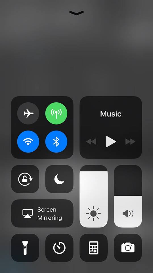

    WhiteFreedom 18 December 2018, 13:28 UTC

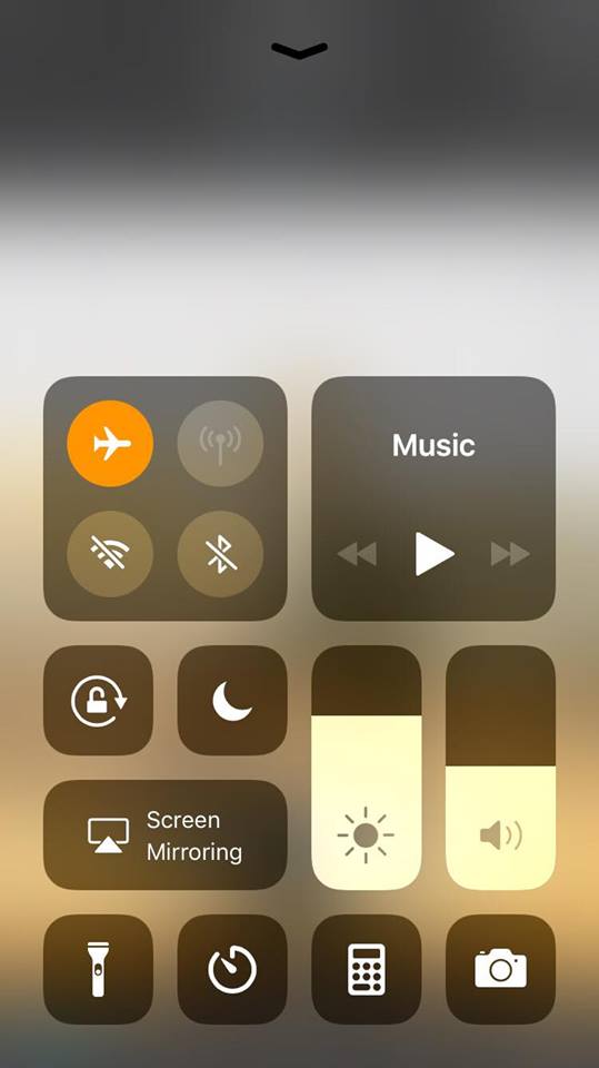

    Hi Onewheel Riders,
    So I recently purchased a Onewheel + XR in France from Freemove.fr (Best service)
    As it is possibly the best feeling available when waves and snow are not around offering me freedom to ride anywhere at anytime I have been using it a lot :)
    Unfortunately I recently started having connectivity issues between the board and the App, so annoying when paying that price for a device.
    That said I would like to share that I found randomly a trick in order to connect/reconnect my board every time.
    Note:
    +iPhone 6s with bluetooth, wifi and data activated.
    +App Version: 2.1.20
    +App setting: Auto connect ON.
    Steps:
    1/Turn ON the App.
    2/Turn ON the board (so far pretty simple :P).
    3/Turn your iPhone Plane mode ON then OFF again.1_1545139624812_OW 2.jpg 0_1545139624812_OW 1.jpg
    4/Back to the app the board should connect straight away
    So far works every-time for me.
    Please note that the connection stay the all ride without any problem :)
    Let me know if it works for you ;)
    Hope it will help.
    Have a Good day Riders

    Hi all, I found out what the Bluetooth problem is, anyone has a XR controller board on their hands?

    tomfoolery @kanguru007 27 January 2019, 04:30 UTC
    @kanguru007 said in XR constantly losing app connection?:
    So what’s the problem? How do we fix it? I’m pretty sure we all have an XR controller board in our Onewheel’s but what do we do to fix the problem?
    Not all who wander are lost
    K 1 Reply   Reply Quote 1
    kanguru007 @tomfoolery 27 January 2019, 11:23 UTC
    @tomfoolery the bluetooth module soldered on the controller board is almost touching the metal plate that closes the box, that blocks the RF (it is surprising that it still works).
    An external antenna is possible and I guess it will increase range and reliability enormously. (can be a 1/4 wavelength sized small piece of wire)
    K 1 Reply   Reply Quote 0
    kanguru007 @kanguru007 27 January 2019, 11:27 UTC
    I would like a better quality picture of the board to have an idea on the easiest way to connect the antenna
    Modern iPhone or hi-end Android with good lighting is good, focused on the bluetooth module (where it says ILT245s)

    Googling for that BT chip yields some interesting results. Other products using it have issues, too. Also found a pin out schematic — apparently the first pin is the antenna if someone with a soldering iron wants to play around?

    rfkilowatt @kanguru007 15 February 2019, 19:56 UTC
    @kanguru007 Here is the user manual for that Bluetooth module. It’s probably worth a look at. ILT254S: https://fccid.io/2AAXH-ILT254/User-Manual/User-manual-2126527
    It does have an external antenna pin on pin one of the PCB module. Not sure if it needs to be turned on to use it. I just sent my board in to “fix” it. I’ll see if it gets any better before trying this myself. I work with RF electronics so doing a little micro soldering is not a big deal for me, but I would doubt anybody can do this with out the right tools.

    @rfkilowatt @kanguru007 I'm in Argentina so sending to USA is no-way (customs cost as hi as U$S 1000 here).
    I'm electronic engineer and I have the right tools, maybe I will try to solder an external antenna (1/4 lambda). What do you think?

    rfkilowatt @gasppol 28 February 2019, 23:16 UTC
    @gasppol I’m an EE too. I’m going to try it with a 50Ohm low gain patch antenna and coax I bought from digikey. I’m going to mount it away from the aluminum cover plate. I’ll let you know if it improves things. That great a software change works with android.

    Anyway, I’ve got news. I fixed it adding an external antenna. Works great now. It took it for a ride and I get realtime speed on my watch. Never worked before.
    I’m trying to find a way to post details on what it looks like. Maybe reddit or imgur.
    The antenna is a tiny little patch antenna that I stuck to the inner plastic part of the controller housing. You do have to unsolder and remount a 0402 cap on the Bluetooth module to remove the internal antenna and use an external one. Not easy, need a really good soldering iron like a Metcal with fine tips.
    Now I’m pretty sure its a signal strenght issue. Maybe it only affect some boards. Getting it reworked by onewheel customer service did not fix it. Maybe they replaced the module, but that was not enough.
    rfkilowatt 5 March 2019, 01:44 UTC
    Here is the backside of the controller board. That’s the Bluetooth module, ILogic ILT254S. Pin 1 is for the external antenna. Pin 2 is ground. That cap needs to be rotated 90 degrees counter clockwise to switch the output to the external pin. This cap is an 0402, which means 0.04” long by 0.02” wide. Really fucking small! To move it (unsolder and resolder) you need really fine tips and a high quality soldering iron like a Metcal.
    rfkilowatt 5 March 2019, 01:45 UTC
    Sorry this is blurry. Here you can see the cap is moved 90, connecting it to the external ant pin 1. I connected an insulated 24 awg wire to pin1 and I put the wire through the ground via to reach the other side. This was my attempt to keep the impedance of the wire closer to my 50 Ohm antenna (lower its inductance).
    rfkilowatt 5 March 2019, 01:47 UTC
    This is the topside of the controller board. That’s the wire popping through from the backside. I soldered in an H.FL connector. I was able to capture two ground points at 12 and 3 o’clock. This important so you can properly ground the coax. After soldering, I added RTV along the edges for stability (not shown).
    The antenna I bought, [Taoglas FXP74.07.0100A] https://www.digikey.com/products/en?keywords=931-1224, has a U.FL connector. I mistook that for being the same as H.FL which I have lying around my lab. It does not mate well to U.FL. When I get a chance I will swap it for the correct U.FL smt connector. I wanted a connector here so you can disconnect the antenna from the board when you assemble/disassemble because the antenna will be attached to the plastic back shell while the board is bolted to the aluminum pan.
    rfkilowatt 5 March 2019, 01:49 UTC
    This is the antenna I bought. I was just looking for something low gain, that was small and 50 Ohms with a connector. There are hundreds of different ones on digikey that I would think would work.
    rfkilowatt 5 March 2019, 01:51 UTC
    Here’s were I put the antenna. The adhesive seems really strong. I don’t think it’s coming off. Coax going to the left.
    After that, I put the shell back on to the aluminum plate. You have to reconnect all the connectors while its barely open, because the wires are not that long. Everything then goes back together like it came apart.
    rfkilowatt 5 March 2019, 01:55 UTC
    @gasppol It might be possible that you could use just a short wire as an antenna. I just want to do it as “right” as possible first to get the highest signal strength. If it didn’t work, I would always be wondering if I just fucked it up or the antenna was a bad match.
    G 1 Reply   Reply Quote 1
