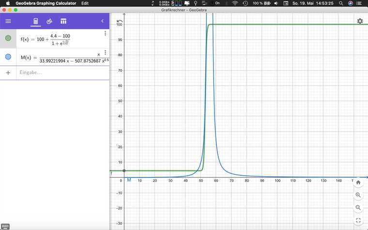

    So the calibration of the Battery percentage was wrong and didn't correctly indicate the battery percentage.
    So I plotted the driven Distance With the Battery percentage. The ride was fairly even and quiet consistent in power consumption. I rode it until the battery was dead ( OneWheel V1) 15 km .
    Then I plotted the Battery Voltage to the Battery Percentage (km of the ride / 15 km )
    Then I figured out the spline interpolation function for the points given
    Here the points x value = Voltage y Value = Battery percentage
    [47,1], [47.9,4], [50.9,4],[51,8,18],[52.7,4],[52.8,43],[53,58],[53.1,68],[53.2,73],[53.62,85], [53.71,94],[58,100]
    for Voltage 47 Volt- 53.75 Volts
    Battery Percentage = Voltage / (33.99221994 * Voltage - 507.8752687 Voltage(^1/2) + 1896.895271)
    for Voltage 53.75 - 58 Volts
    Battery percentage = 100 + (4.4-100)/(1+exp((Voltage-53)/0.42))
    I will make a little App for myself to bypass the difficulties of the Official OneWheel App.
    Hope this proves useful to some of you out there...![alt text]
    Here the graphs of the sigmoid and exponential function plotting voltage to Battery percentage
