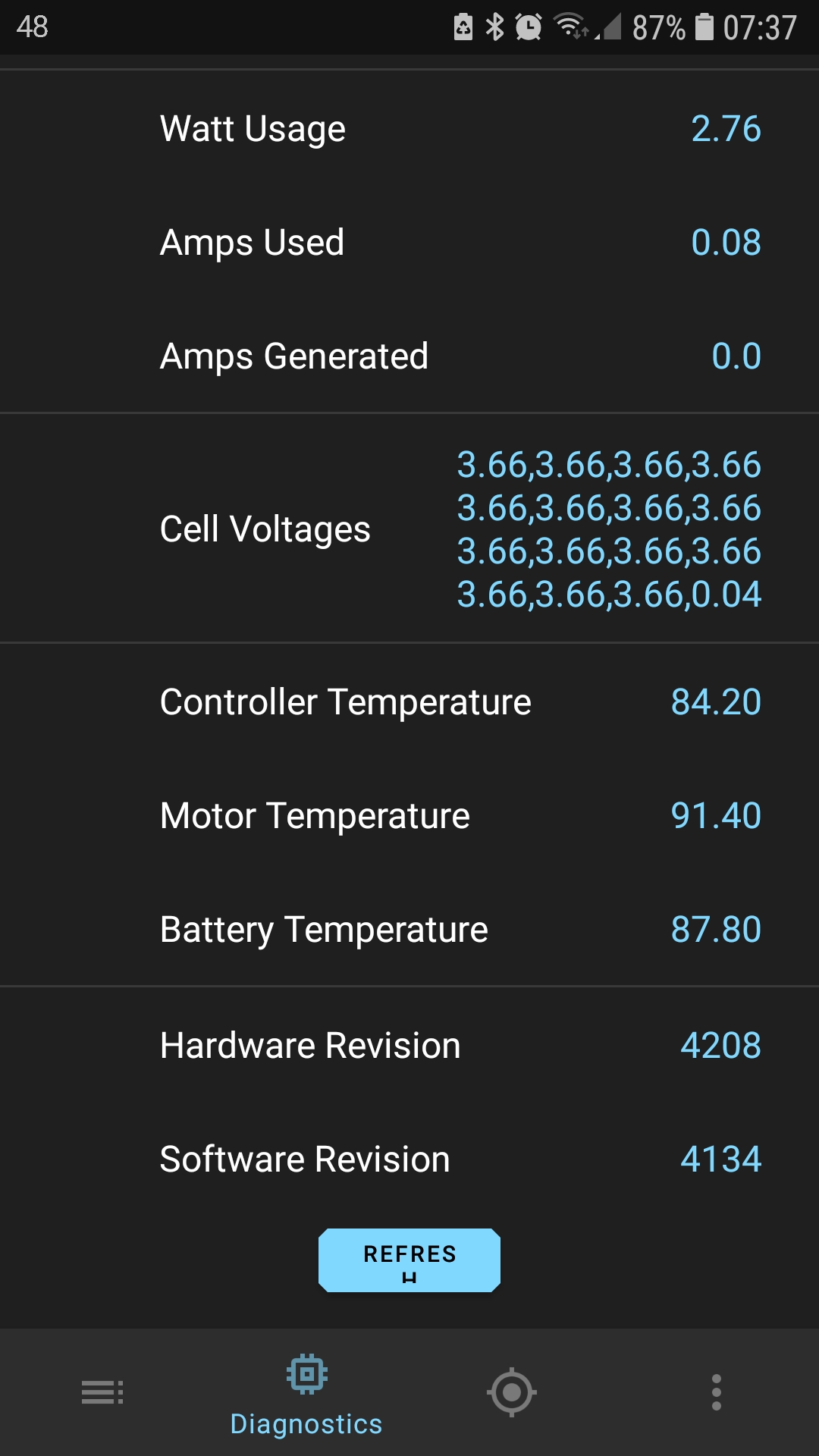

    @speedracer find an android phone and install the Onewave App to connect and check your cell voltages. Screenshot below is what you can expect.
    Download from here.
    https://github.com/Nanoux/Onewave
    S G 2 Replies   Reply Quote 1

    gasbreakdipper @stinkyface 13 May 2020, 03:53 UTC
    @stinkyface the last reading of 0.04 look odd..
    stinkyface 1 Reply   Reply Quote 0
    stinkyface @gasbreakdipper 13 May 2020, 11:26 UTC
    @gasbreakdipper said in Board slowing down and stopping uncommanded:
    Yep. All the Apps allow for 16 cells. Which is whats in the plus and v1. The XR and pint cells are a different chemistry and have a higher nominal voltage, so there are only 15 cells. So the App basically reads zero for the non-existent 16th cell for an XR. All normal.
