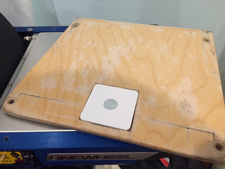

    Tile Slim = Poor-man's Lojack

    The tile is a nice touch, although it has limits. Warns you if out of range of your cell, but depends on crowd sourcing to locate once outside of your coverage zone. But sure better than nothing.

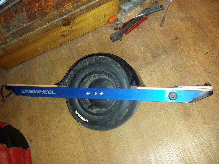

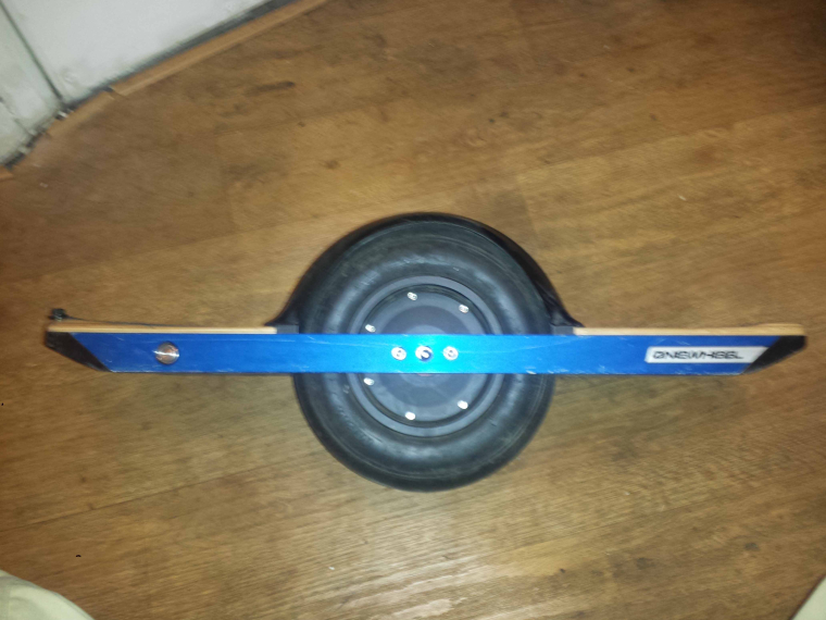

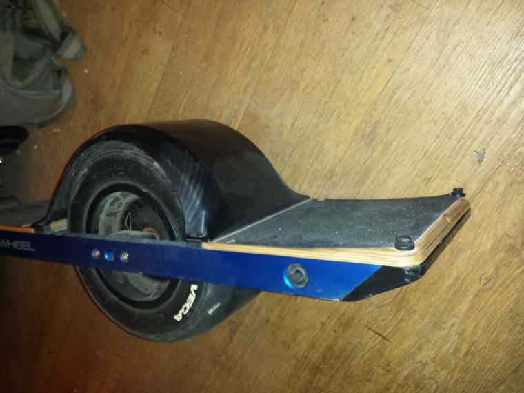

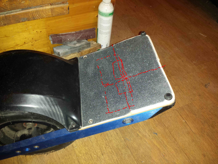

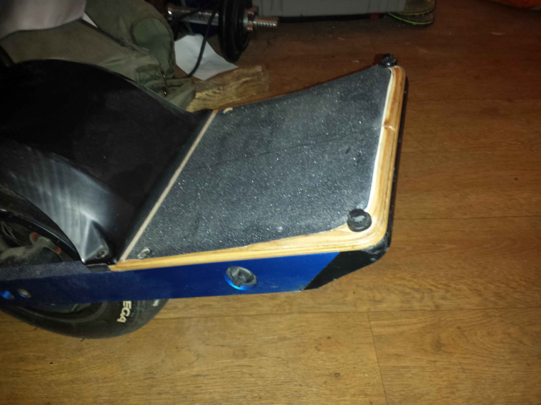

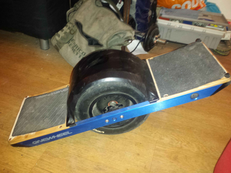

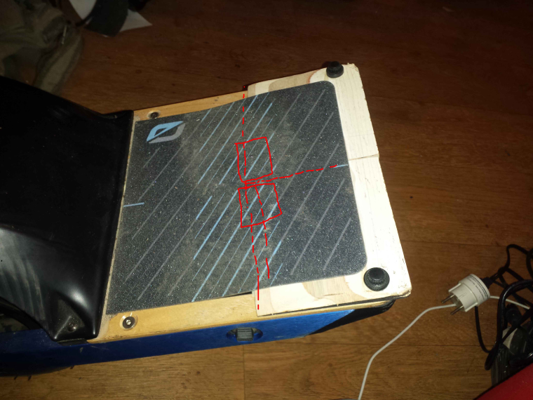

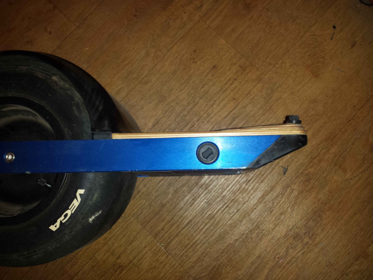

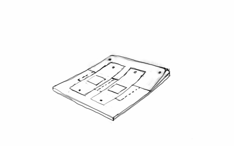

    i was impatiant so I made a frankenstein prototype( I had a spare set ...saving that one!!;);)....and it works :):)...from the sensor area to the outsidecorners...next to wheel is the safe area LOL...also using the original screwplaces...so could be non destructive...lift up 1 side of the tape...insert the 2 ramps...put the tape back...ready to go....:):):)?!?!?!?!?!
    I used 2 sepperate ramp pieces...didn't have long enough screws so had to use these things and 2 rubbers...
    I kept a part of the original sensor coveringtape because I was worried about the wood spacers direct contact on the shiny sensor...so kept the tape on the sensor and put the spacers on top....and the 2 ramps on top of that so for now it is a bit higher then necessary...the gaps are bigger now but can be held shut without triggering the sensor...
    if I step on it..i can keep my toes on the outer corner and still powered...weight to my heel instead of toes..works to stop..next to wheel stops...but the far corners will trigger so..:)..also because of the grip tape I think
    step1.
    step2
    step3.
    4.
    for now it works...snowy outside ..and still crapy prototype...but...:)...
    hope you enjoyed and hope to inspire...
    and would really prefer thin sensor sheets haha or something so hope that works for someone...please share :):)
    (I only had a livingroom and a dremel&sandpaper to work with so I know...it looks crappy:):).

  • No @timvdp 14 February 2017, 02:13 UTC
    @timvdp that looks really well done, how does it feel to ride? and are those black knobs there as foot-stops?
    T
    timvdp @No 14 February 2017, 02:33 UTC
    @No
    can't do much outside riding now because of the weather
    feels like the most of the pad activates.......but I have big feet haha..the screws: Because I went higher I needed longer screws and these black ones was all I could find...but during testing it was handy aswell for taking on and of again...~and as you said could function as a foot stop~
    maybe you could fit a piece in between the 2 screws as a stop aswell...I'm gonna get smaller screws for a clean look...same as original but a bit longer
    (when screwing down be carefull of the original screwhead cavity in the footpad if you are gonna sink the holes in the ramp!;)
    ..maybe fill up?..)

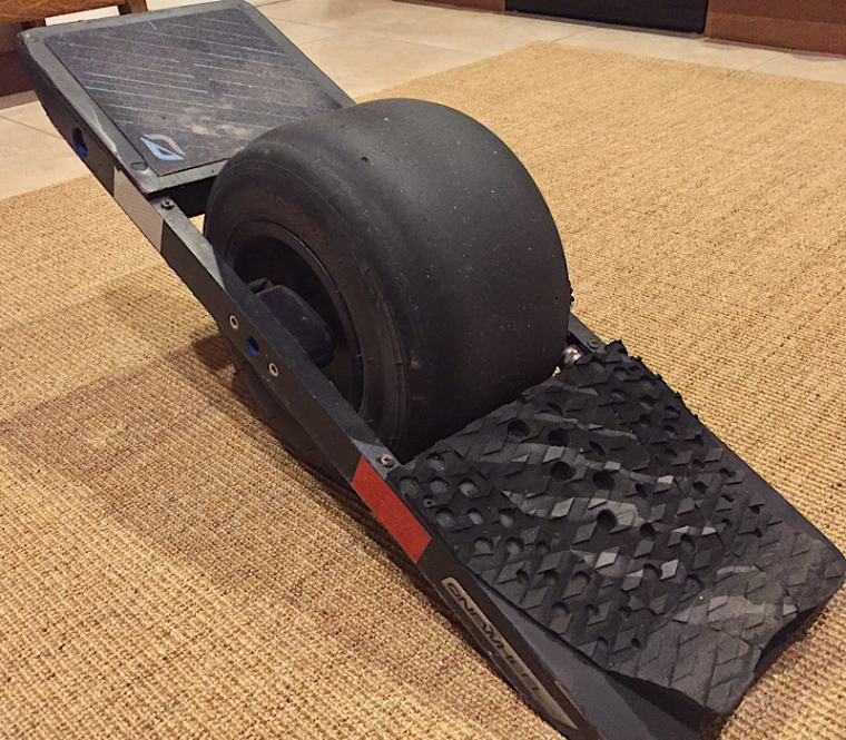

    I saw a few people add a surfboard kickplate to the back deck of their Onewheel and it seemed like a great idea so I had to try it. I love it! It really gives you a lot of additional control, especially when turning/carving, and it's great to always know where your back foot is without having to look.
